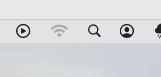

I have WiFi enabled on my Mac mini which is also connected to wired ethernet, but the mini is not logged in to a WiFi network.
The fan-shaped WiFi icon on the task bar is greyed-out. Airdrop works perfectly.
Have you tried that?
