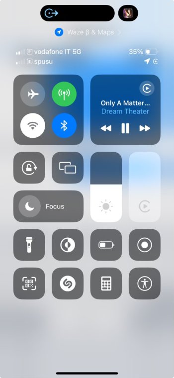

Hello all,
I just mounted a Carpuride YT09 stereo to my car, which has no controls on the steering wheel at all. CarPlay works fine (I think; I never had it before) but, lacking physical buttons, I have no idea how I'm supposed to change the volume. The side buttons on my iPhone don't work, and Control Center shows a locked volume slider with the CarPlay icon.
The only way is to: tap the home screen button on CarPlay, tap the "Car Home" icon which exits CarPlay, tap the volume button on the unit's own home, move the slider. It's basically impossible to do while driving. (A separate issue is that it kind of over-amplifies audio, so that even though it goes from 0 to 39, the only sweet spot is 4 and 6; even 9 is already way too loud.)

Doesn't your user manual for the Carpuride tell you how to make a volume control appear on the screen?
Looks like you just do a short-press on the power button, and you should see a volume bar.

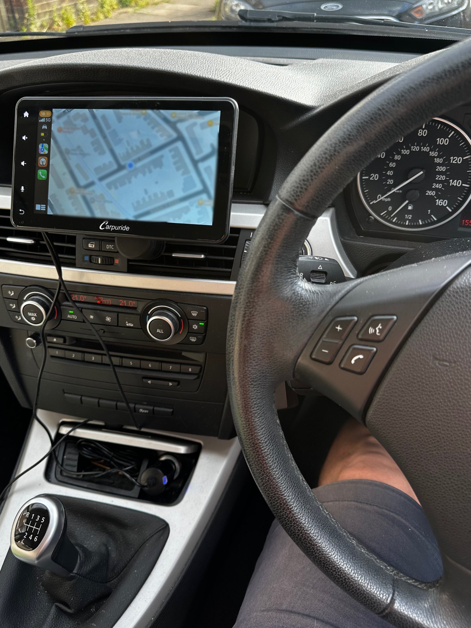

If you were to go back to your Sony stereo then you could get one of the CarPlay units that has a line out and BT and have it connect to the stereo I assume? I've got a 14 year old BMW and have the original factory stereo still fitted. There is a line-in and I just connect a Carpuride unit via an audio cable and set the source to AUX and can use the stereo volume control and the steering wheel ones.
The mount that came with the Carpuride unit was pretty terrible so I bought a Quad Lock vent mount and stuck an adapter for that on the back of the Carpuride unit. Works great for me. Though obviously doesn't look as tidy as a fitted unit (I have however since tidied up the cabling somewhat from what is shown in the photo!).
