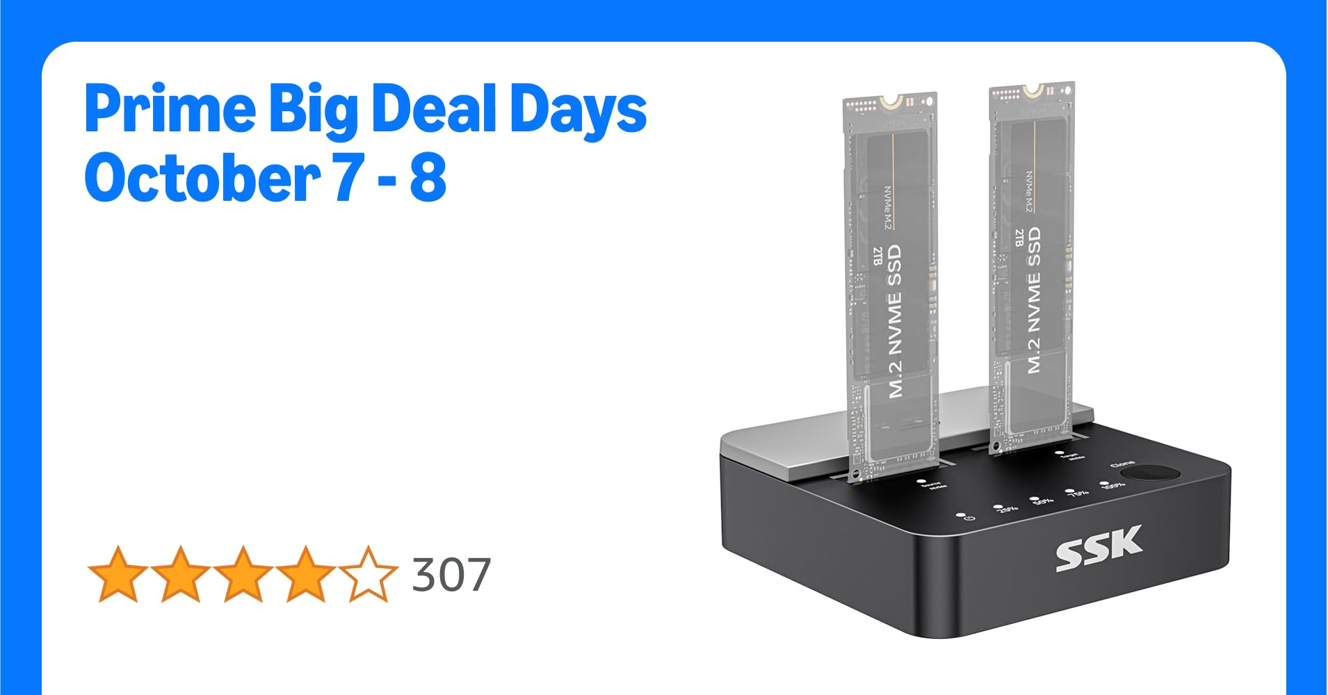

You could always use an offline cloning unit. It's an additional purchase, but I find its quite handy to not only clone, but also connect and access data from NVMe drives without using a full external enclosure.......
Just another option......

You could try something like this - doubles as a plug-in M.2 reader for Mac. Maybe not worth it for a one off job but it’s a handy tool if you’re messing around with M.2 sticks.
Cloning is a stand-alone operation - doesn’t have to be plugged in to the Mac. Disclaimer: I haven’t tried it with APFS format sticks.
Yes, I did look at those and I have similar for HDD's, but I can't see me having much subsequent use for one so it would sit in the drawer. I think I will go for a Zike drive and together withe the redundant 1TB drive, use it as a backup drive in some way. Still uneasy about mixing Time Machine B/U and other data on same drive!
