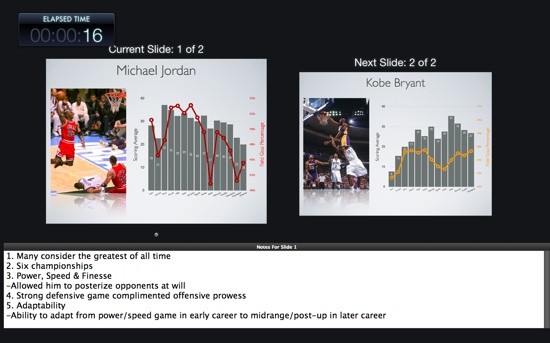

I actually really like using keynote with the lid open. It will show you the next slide, time spend on current slide and overall time of presentation. Quite helpful, if you ask me.

Yes I do know about that, and it is useful, which is why I don't understand why one would want to have the mbp closed, apart from making it run hotter there is no advantage.
