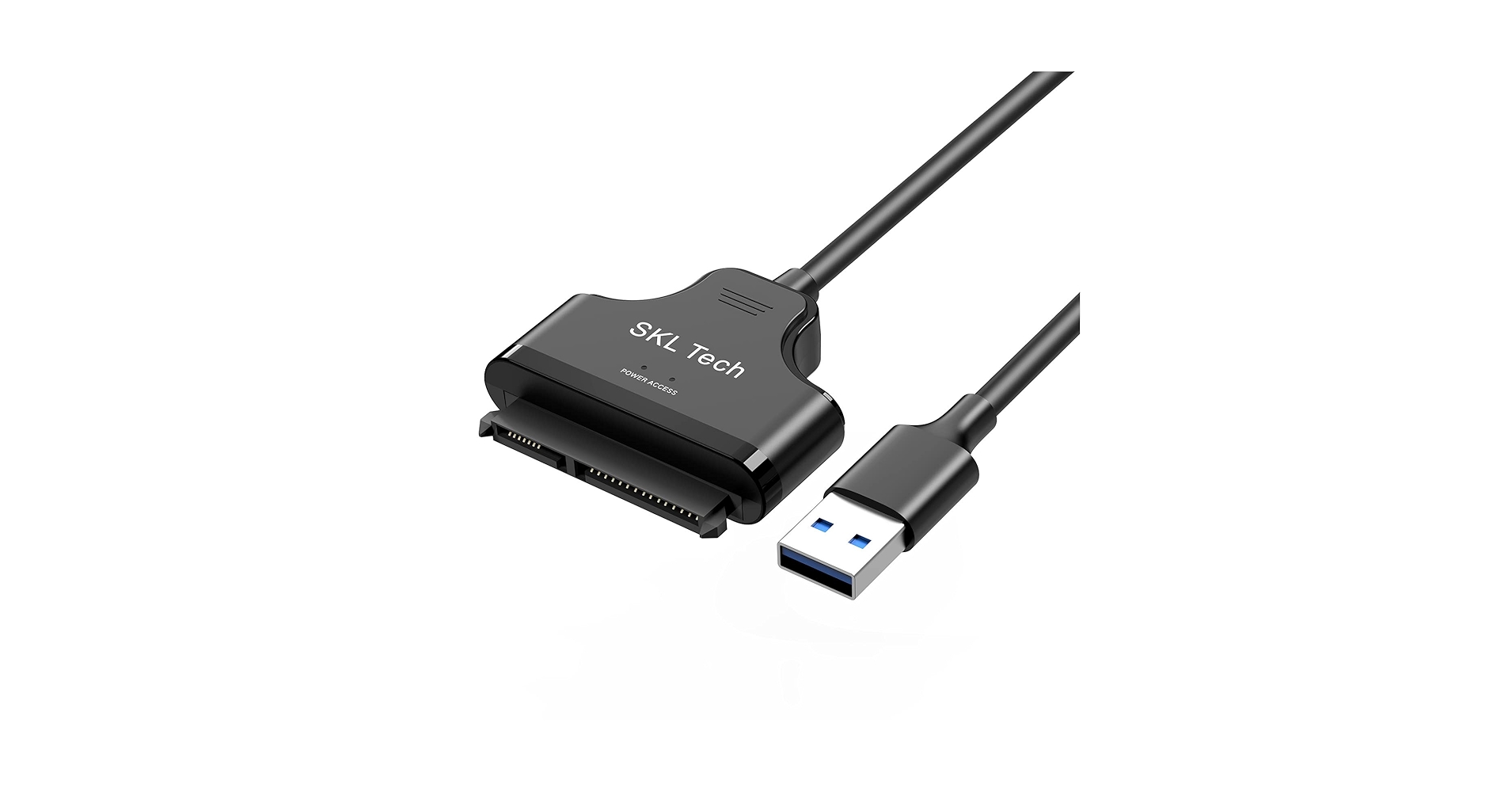

Some sort of macOS corruption is only a theory at this point and you might be able to save yourself a hassle by just cloning your internal to a new SSD attached via USB and seeing how that runs. If it runs well you can then swap with the internal.
You don't need a housing, really. One of these will do:
