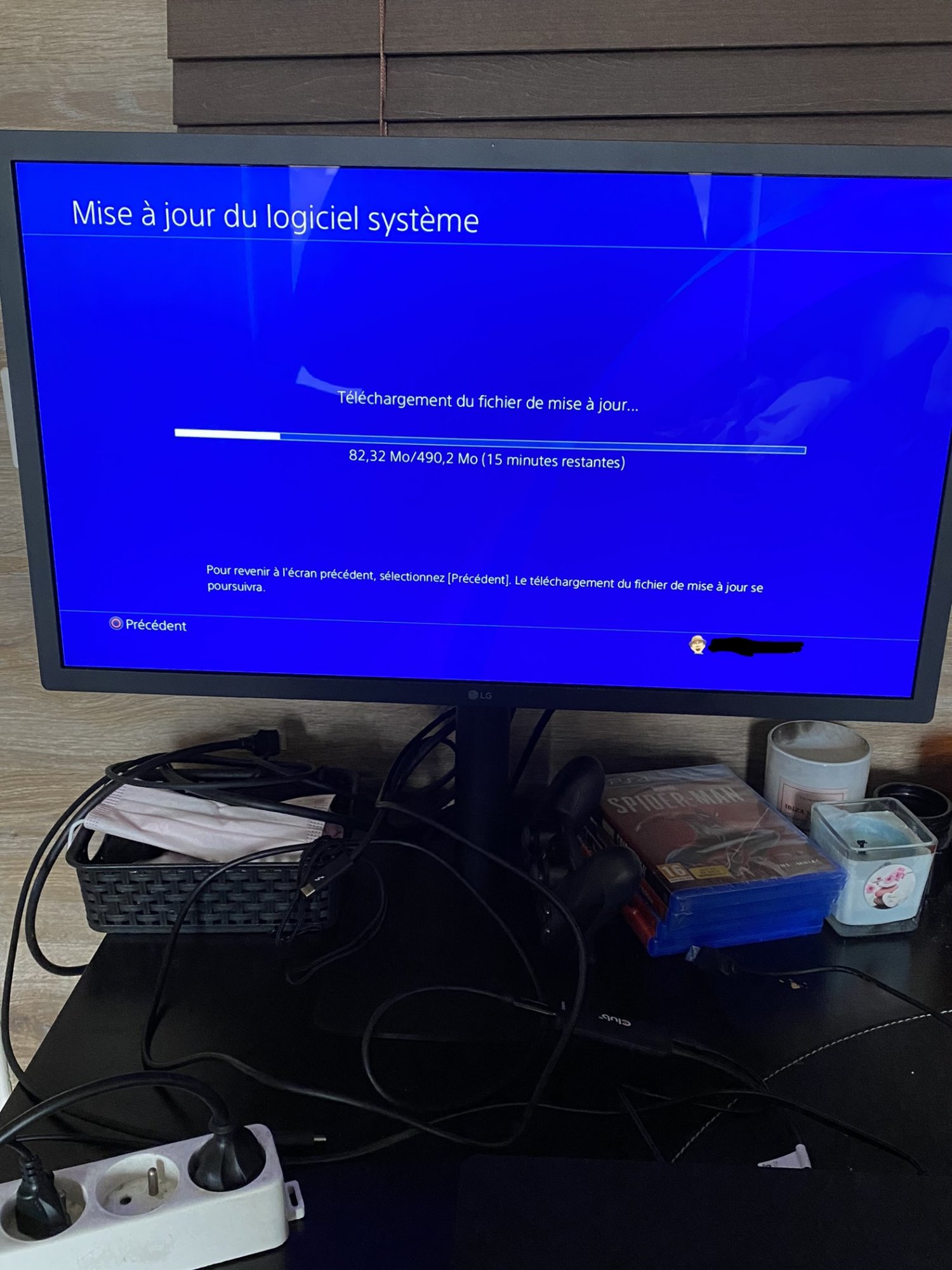

The video is with MacBook charge cable and thunderbolt 3 cable

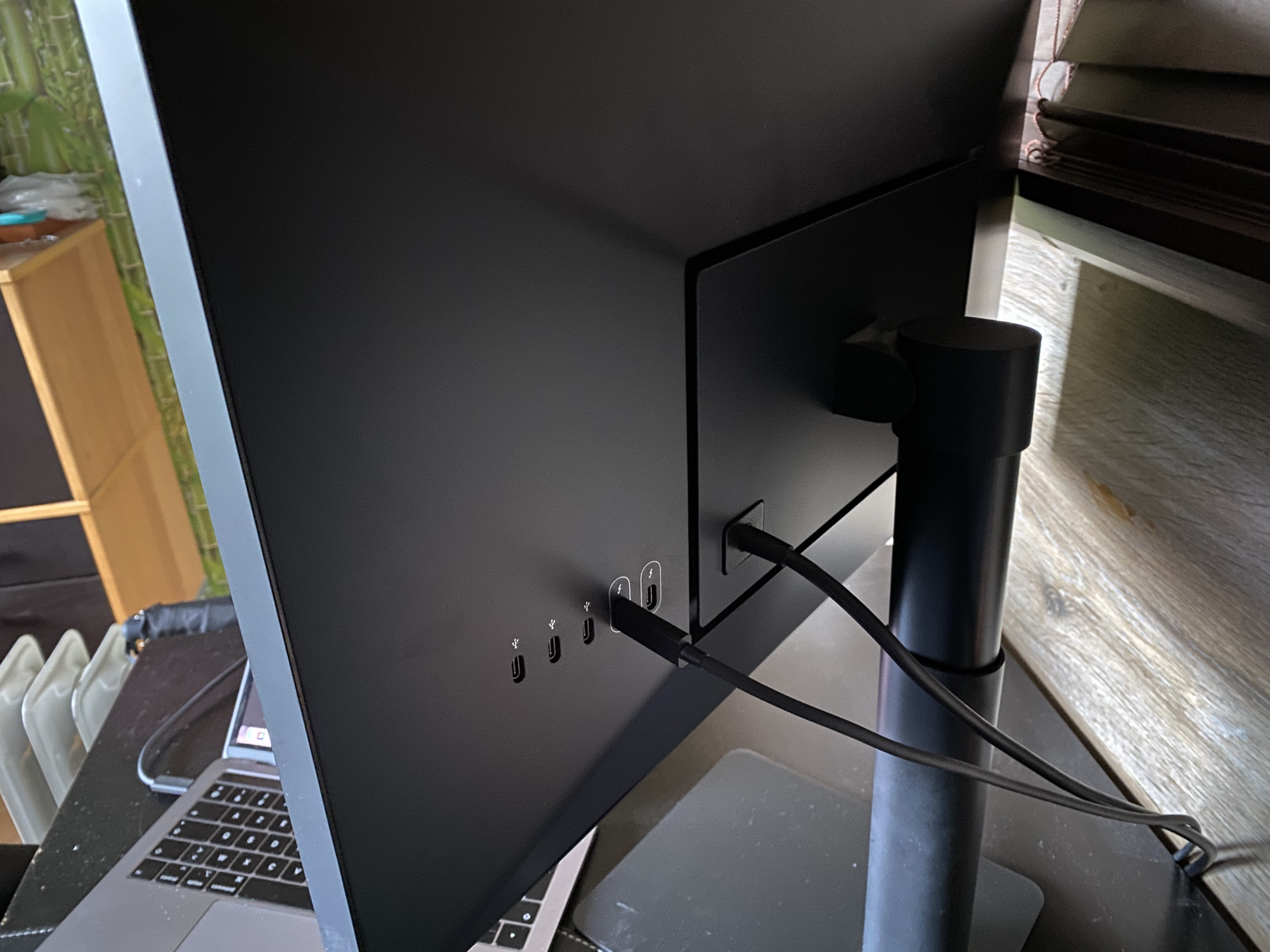

Hello,
I come back for say thank you @Amethyst1 because it works with the cable 👏

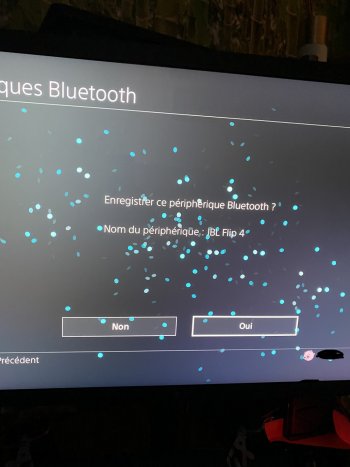

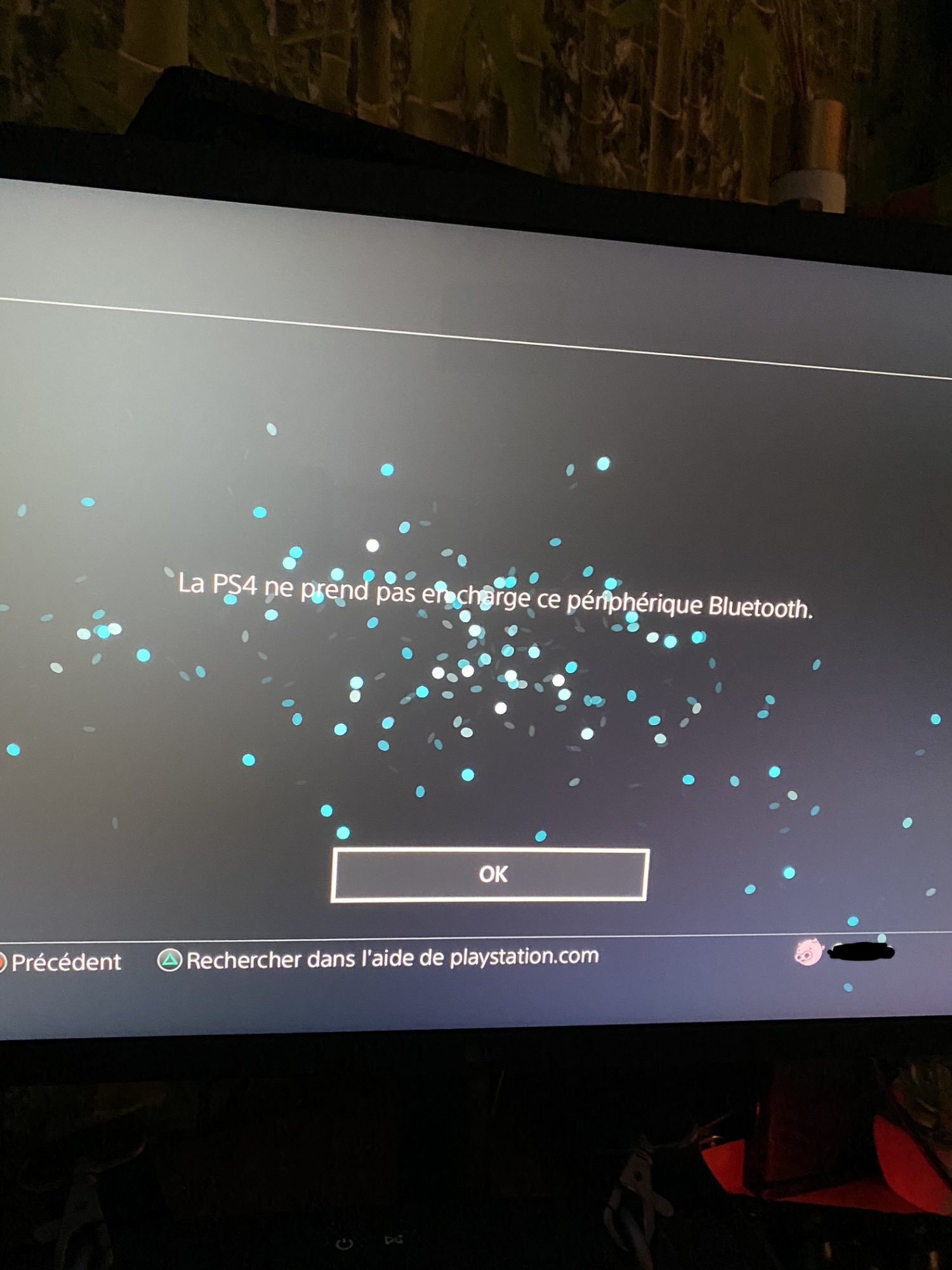

Hello,
Yes it take bluetooth but not the speaker.
