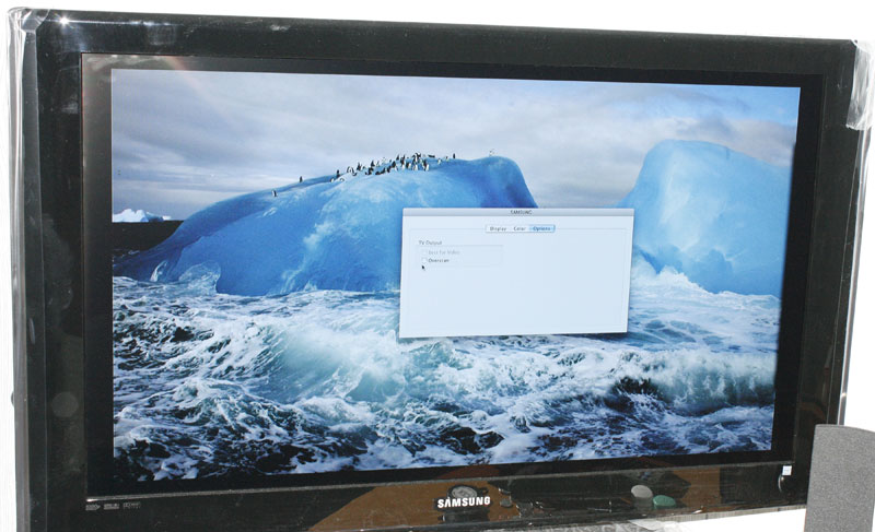

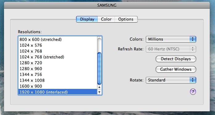

Well, I do have a MacBook, 2.0ghz. I have no trouble running a 40" samsung 1080 tv, either in 2 screens or mirroring my display, I do have 4 gigs of ram, so that might help the anemic amount a vram all the MacBooks have. All you need is a dvi to hdmi cable, you can find it in any of your big name retailers in the US, or order it online for 10X less money. Since the MacBook has only a mini dvi out I had to get also a mini-dvi to dvi adapter thru apple. Your Mac should be able to give you enough options thru the displays preferences, it usually gives you the option to overscan, otherwise you get a nice black frame around the image. Not a problem with movies and such but it is bothersome if you want to use the tv as your main display, as it will not let you see the top menus, So you either get the whole screen or only part of it. The other thing is that you need to find a way to route your audio out of the Mac, hdmi transmits audio and video, but dvi only gets the video out of your laptop in this case. Not a problem with me since I use desktop speakers anyway.
