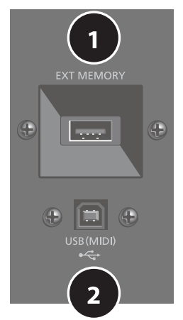

I want to make some tunes on logic pro. I have this electric piano
http://www.rolandcorp.com.au/products/productdetails.aspx?p=1164

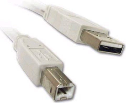

Is it possible to hook it up and if so what cables would I need? Many thanks.

There are two ways to connect them to a computer:
1) using the industry standard "MIDI" plugs. These are two round five-pin connectors and these are universally comparable with "everything"
2) USB. Some boards use USB but then you need special drivers on the commuter and you hope they will be abatable after an OS upgrade.

If your keyboard is "real MIDI" with those two round plugs you need a pair of MIDI cable and and MIDI to USB interface. The best plan is to buy an audio interface that has MIDI also all in one box. Like this:
http://www.presonus.com/products/AudioBox-USB
Then you need speakers and headphones.
But notice that the Roland piano that you picked out also can make sound all on it's own. In fact that model is very good at it. Better than the software that comes with Garage band. So there is a completely different route you can take. MIDI data is jet key presses. MIDI is not sound it just says "key down" and "key up" and then software generate the sound. But with this Roland the internal sons is good so you might want to record tis audio output. You can do that also with the Presonus AudioBox but you need a pair of audio cables.
