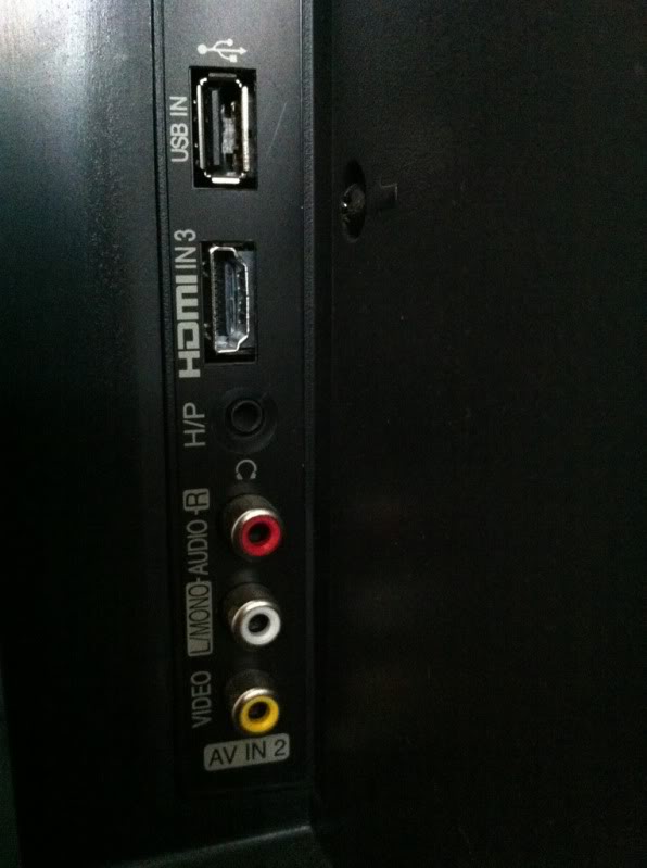

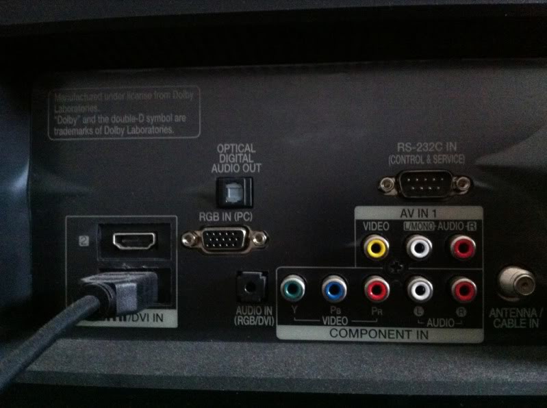

Is there any way I can connect my MBP Model A1211 to my LG flat screen?
Here's the ports to my TV
Which cables do I need? Or is this even possible?

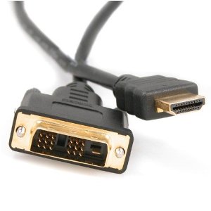

Link was to this cable but looking at my MBP the port doesn't have the gap in the middle.
Is this the correct cable?
That cable will work.
The gap indicates a SINGLE-LINK DVI cable, the MBP you have has a DUAL-LINK DVI port, but the DL DVI port does accept an SL DVI cable.
The SL DVI cable is able to transfer 1920 x 1080 pixel to your TV, the DL DVI port is used to connect a display with a resolution of up to 2560 x 1600 (30") to it.
