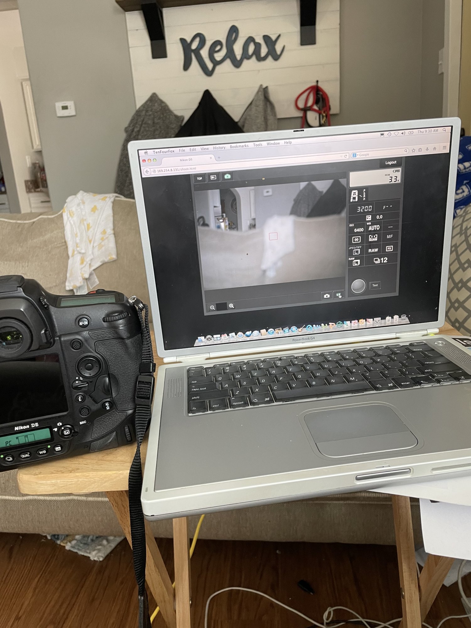

Still, though, I couldn't help but get excited over camera control over ethernet, and I found it actually worked quite well. The beautiful thing, too, was since it was a web browser app, I reasoned it should be at least somewhat platform agnostic.

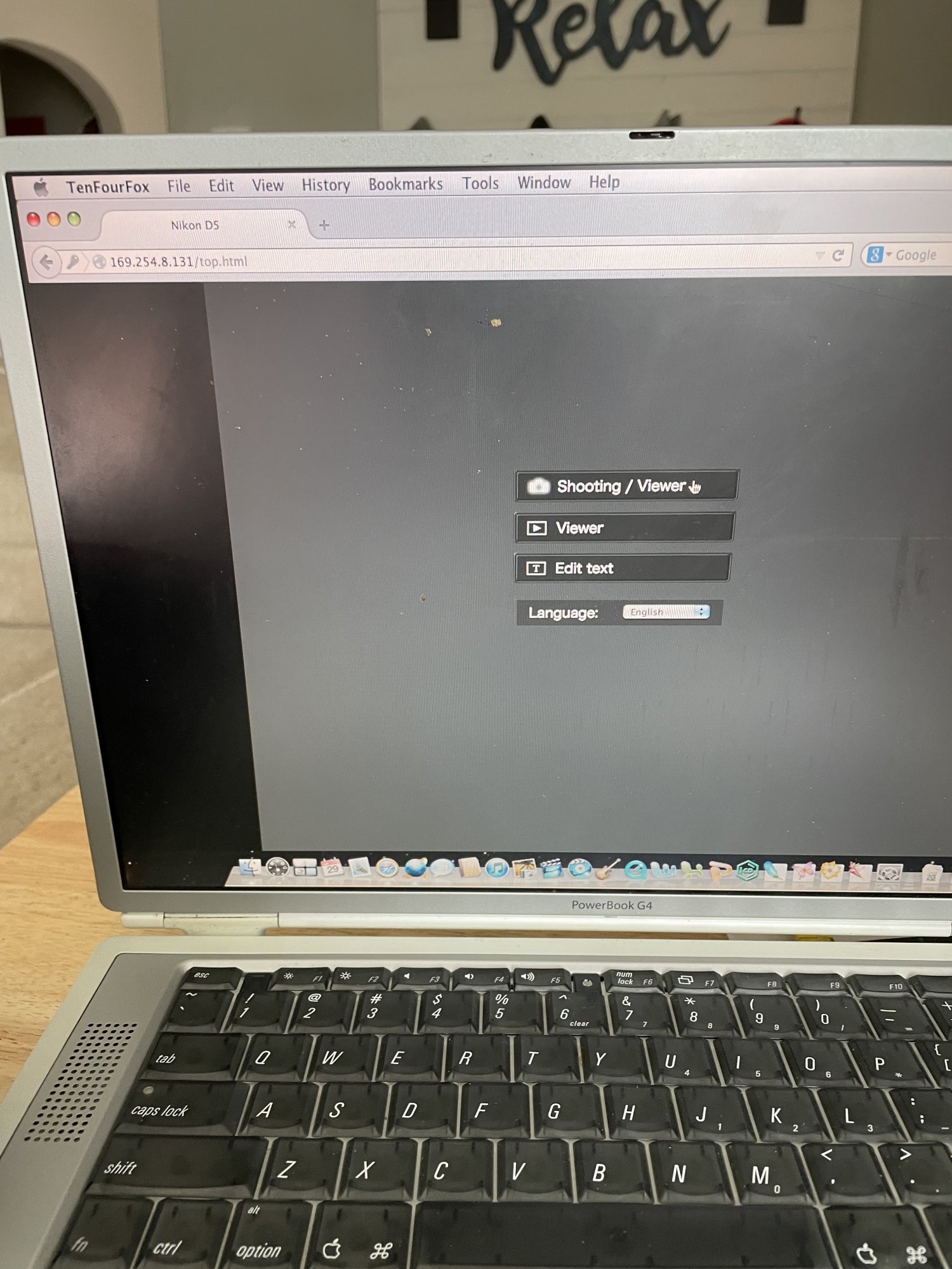

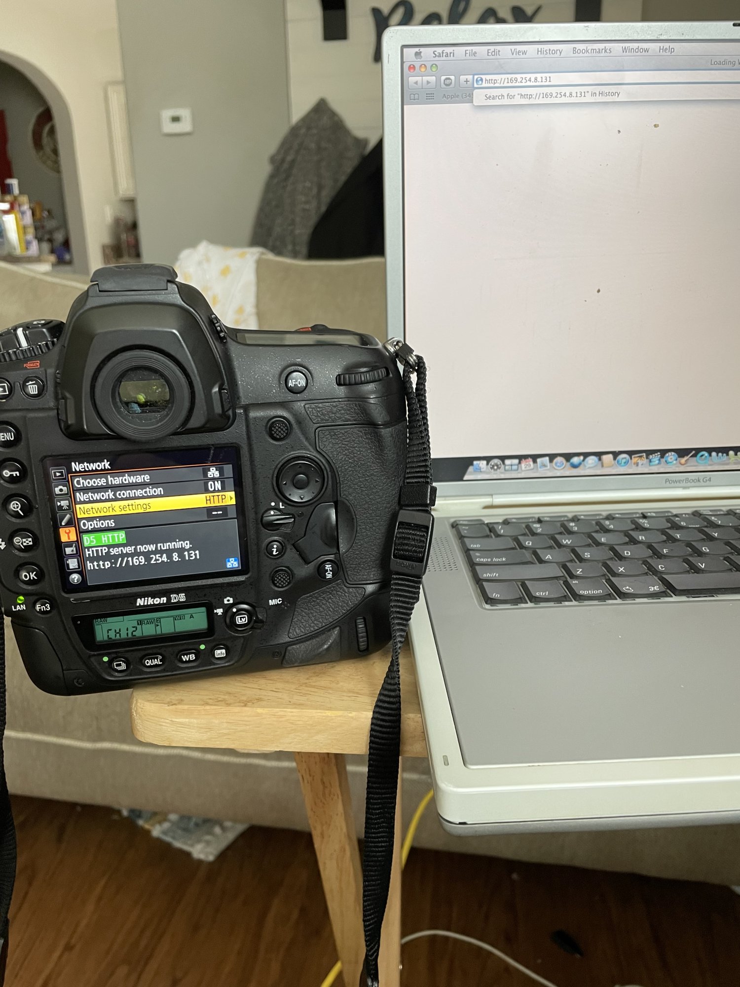

With that in mind, I had a few minutes this morning to play with it and decided I'd pull out my TiBook and try. I hooked it up-really nothing fancy, just a simple(not crossover) ethernet cable from the camera to the computer-and started up the HTTP server in the camera. For those of you who may have one of these, here's the general step-you can find this control through Menu->Setup(wrench icon)->Network. Once in network, select "Choose Hardware" and be sure it's set to wired. "Network Connection" should of course be set to "on." For "Network setting" you will need to create a profile, use the wizard to create an HTTP server, and set a user name and password for the camera. I named this profile "D5 HTTP" but you can call it whatever you want(and can also create/modify the profile by connecting the camera to a computer via USB and running the Wireless Transmitter Utility https://downloadcenter.nikonimglib.com/en/products/168/Wireless_Transmitter_Utility.html ) . Be sure this profile is active, then connect the camera and computer together and wait for the server to start up and provide you with an IP address.
Initially I tried this in Leopard Webkit, but it did nothing when I typed in the IP Address and hit enter.
TenFourFox worked perfectly, though
