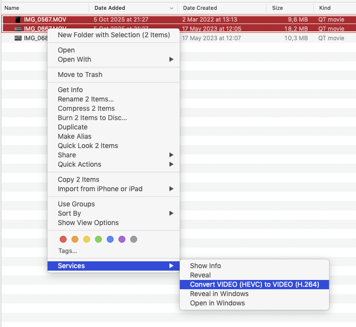

As promised, I'm back with the final results:
a MacOS Quick Action Service which makes it simple to convert any H.265 video file to the more widely standard H.264 video file format.
It's been tested in MacOS 10.14.6 (Mojave) but will hopefully work fine in other MacOS versions as well.
I made it because I had many H.265 (HEVC) videos and "Live Photos" (HEIC/HEIF) video clips which are unviewable in Adobe Lightroom 6 on my Mac, thanks to the iPhone's default Camera app setting (I recommend changing its "High efficiency" default Format setting to "Most compatible" instead)
An easy to read guide is included inside the attached ZIP file, but basically you just unzip it (double-click the downloaded ZIP file), then double-click the Quick Action Services file to install it. Once installed you just select the video(s) you want converted, then right-click to select the Service "Convert VIDEO (HEVC) to VIDEO (H.264)".
Finally, thanks to everybody who's helped me in this current thread and Services Quick Action w/Shell script -dealing with files, especially @!!! , @Greybeard2017 , @bogdanw , @Red Menace , @jackerin and numerous others for invaluable help I've received here and in the Services Quick Action w/Shell script -dealing with files thread.
  • MacOS Service -convert H265 to H264 video.zip
Reactions: bogdanw

But my script is basically revolving around the following FFMPEG command:
Bash:
ffmpeg -i "$ORIGINAL" -c:v libx264 -pix_fmt yuv420p -crf 18 -preset slower -c:a copy "$CONVERTED"
(Where "$ORIGINAL" is a reference to whatever file (H.265/HEVC) needs converting, and "$CONVERTED" being the resulting converted H.264 file.
I would first look up any FFMPEG documentation concerning the file-types you wish convert, and change the script accordingly, assuming FFMPEG handles that format.
To simplify things I'd use the MacOS Terminal for experimenting with different FFMPEG parameters. That's what I did.
Specifically, the above code would be written like this in the Terminal:
Bash:
ffmpeg -i ORIGINAL.MOV" -c:v libx264 -pix_fmt yuv420p -crf 18 -preset slower -c:a copy CONVERTED.MP4
(replace ORIGINAL.MOV with the filename of the video you want to convert. CONVERTED.MP4 will be the resulting converted file).
PS: if you go to the Services folder (~/Library/Services/) you can click on this Services Quick Action file which will open it with Automator.
Since I've added lots of comments within the scripting it should be relatively simple to adapt it for your (or others') need, once you figure out the FFMPEG command for your specific use.
I suggest you first put a few copies of your iPhone's Dolby Vision HDR video-files into an empty folder for testing purposes, navigate (cd) to that folder in the Terminal (or: type cd (with a space at the end), then drag-drop the test-folder to the Terminal window which will paste the path of the folder) and press RETURN.
From now on you'll reside in that folder location using the Terminal.
Hope that helps :)
