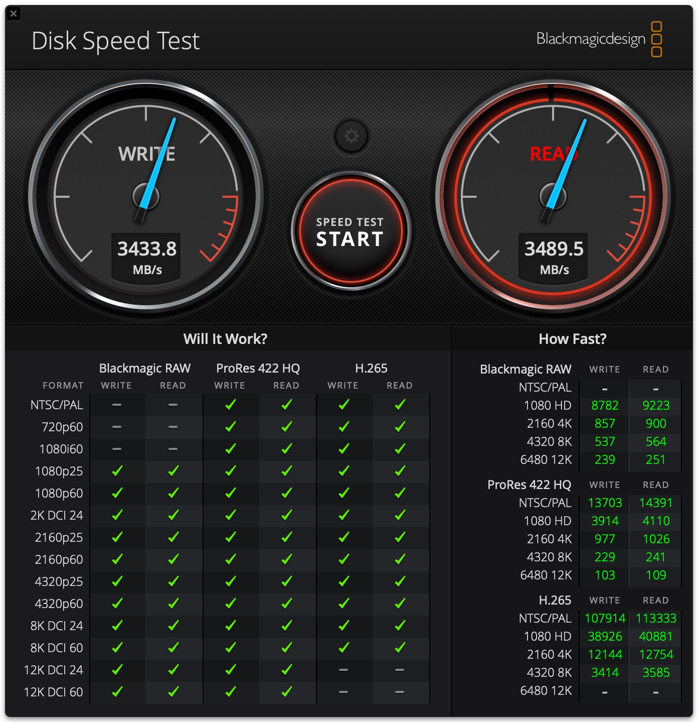

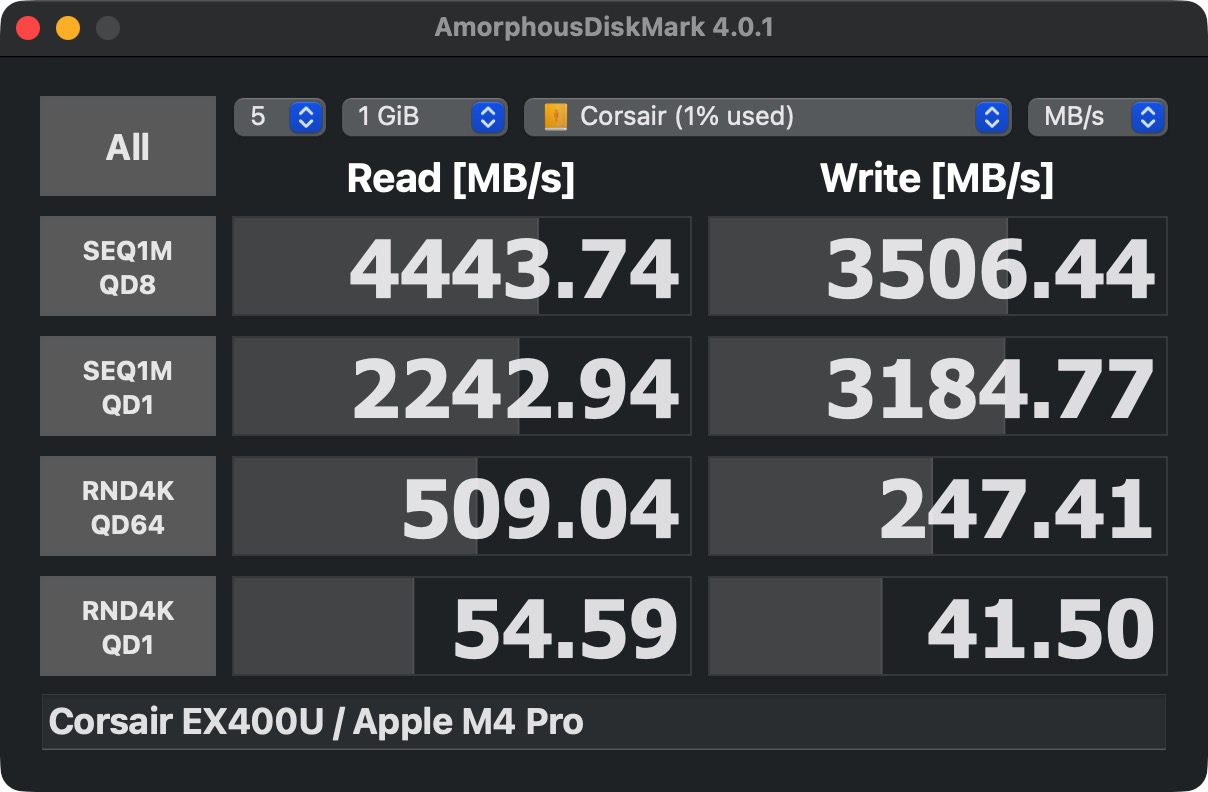

My response is yes, it's a solid option. I have a MBP M4 Pro and I use it as my TM drive. The issues earlier in the year involved a small batch of the drives. The serial # range is listed on Corsairs site. I've had no issues at all with it and the performance is as-advertised.
