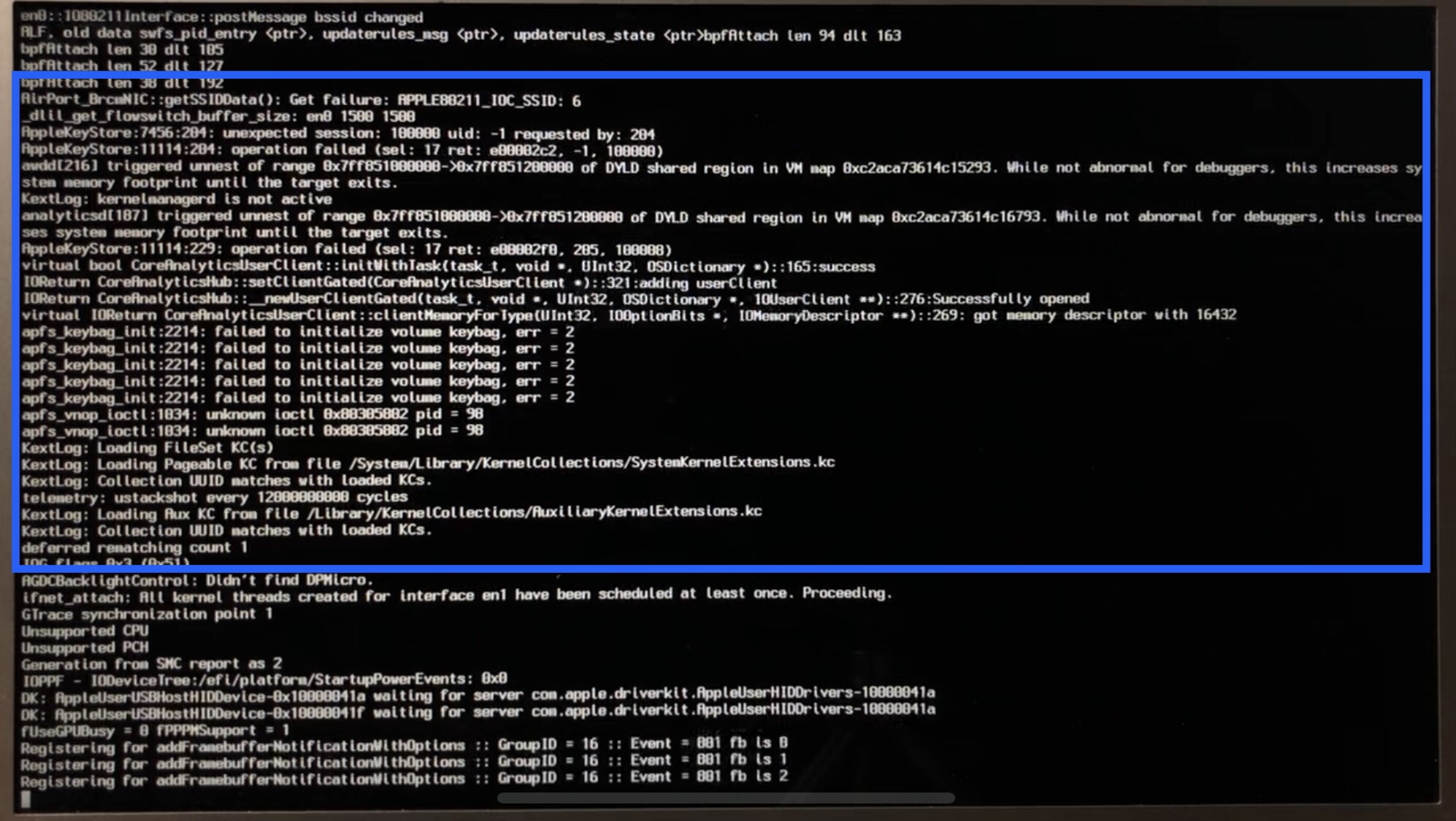

Thank you. Below is a screenshot of where the stop happens, at approx. 20 secs into the boot. The computer "hangs" at where the cursor is at the bottom. After 7-8 seconds there, it goes directly to the Apple logo again and swiftly reaches the desktop.

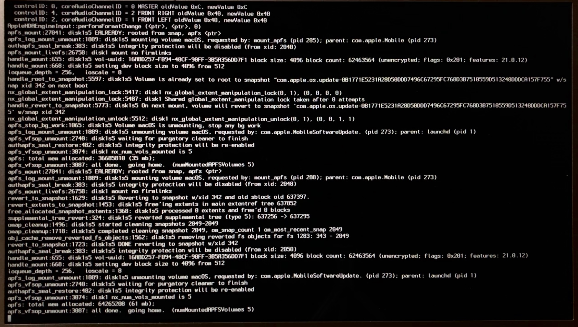

There process also slows down at about 8 seconds. The marked part below takes 5 seconds to pass, with each line ticking by slowly.
Can something be told from this as to the reasons?

Searching around I found that the reference to "keybag" in the second screenshot (and not the cause of the longer "hang") could have something to do with previously having stored encrypted iPhone backups on the computer. A recommended solution was to reinstall via internet recovery. This was unlikely as I have not used the computer for such backups as far as I can remember.
In any event, internet recovery appears not to have helped. The boot process still slows down, verging on halting at around 1/3 in. Verbose mode reveals that it stops at the cursor (see first screenshot above) and slows down at the same keybag messages as in the second screenshot.

FileVault on? If so, need to do the initial decrypt of the OS to do the actual boot (FV login screen is bare minimum to allow for user input).
Looks like "antiques" so yeah, not going to be peppy.
Unsupported version(s) of OS? That might be a reason and might get better answers in the "XYZ on unsupported Macs" thread.
