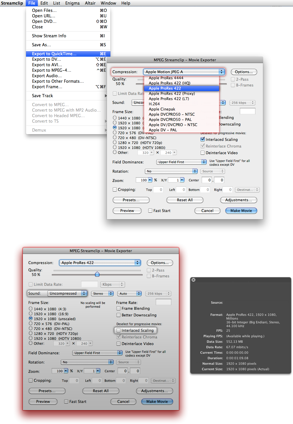

.mp4 files can be transcoded via MPEG Streamclip via these settings:
click on the image for a bigger version:

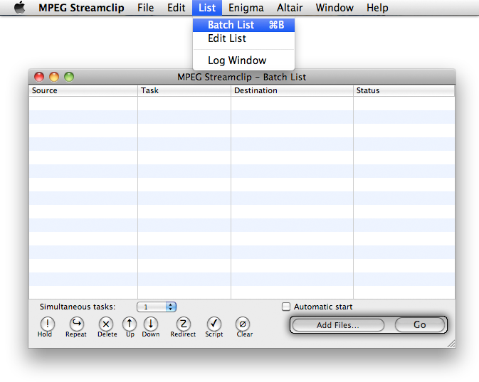

MPEG Streamclip also has a Batch List (CMD+B):
That Batch List will allow you to batch transcode multiple .mp4 files with only setting settings once.

Hey thanks for the reply, I used 'log and transfer' for the mts files. As for the M4v, I was a bit short on time so I went with mpeg streamclip (as I hear it is faster than compressor) to transfer m4v files ProRes 422(LT). The question I also seem to be iffy with about mpeg is the converting settings, like frame size (unscaled, 720p, 1080i), frame rate and deinterlace or interlace...
Just using my better judgement I used 720p (for HD footage) and deinterlace, which seems to looks fine.
