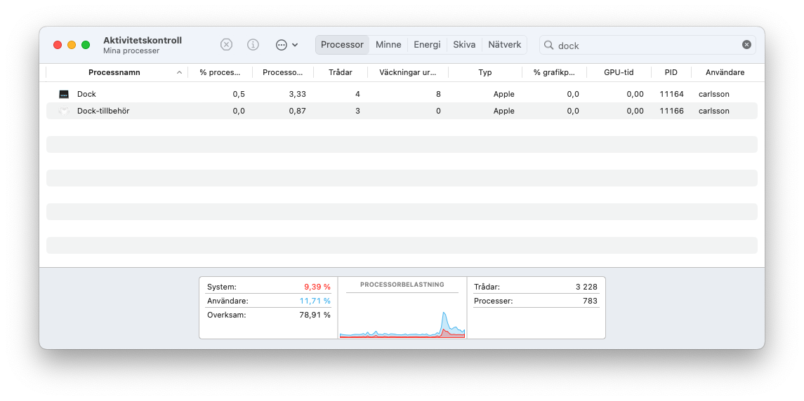

To make a long story short, I need a one line command that kills all processes that contains the word "dock".
(Background is that the Dock freezes for me when I disconnect my monitor (it started with beta testing Sonoma), and after spending conuntless hours and days of reinstalling everything from scratch, I can't get rid of this problem (it works as it should with a fresh user, but returns after a couple of days, and now I don't have more time to search for the reason of this behavior).)
So, instead of opening the activity monitor, search for "dock", and kill those processes, I want to make an sh command that just kills them. That way I can create a shortcut with Keyboard Maestro and save a lot of time!
However, I don't know the correct use of 'grep' in combination of 'kill'.
Anyone that can help me?
I have tried with killall Dock, and that works for the Dock, but as you can see on the screenshot I also need to kill Dock-tillbehör, and I got this message when I try to do that: "No matching processes belonging to you were found"
I guess this is because there is an "ö" in the process name.
It's these processes I want to kill:

The process called "Dock-tillbehör" is called something else when I look at it with top in Terminal.
However, I only see the first letters due to the column is to narrow. "com.apple.dock.e"
So, I thought it was "com.apple.dock.extra", and did a:
killall Dock com.apple.dock.extra
Didn't work.
So I realized I Force quit the process when I'm in Activity Monitor.
But I don't know how to Force quit from the Terminal. Looked at man, couldn't find it. Tried with -f, didn't work.
Any ideas?

Finally I have a terminal command that works. It looks like this:
killall -KILL Dock com.apple.dock.extra
