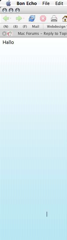

Now, if I just try out this code
PHP:
<html>
<head></head>
<body style="background: #fee url(sdf.jpg);">
<p>Hallo</p>
</body>
</html>
I get it working, but the gradient doesn't seem very smooth...

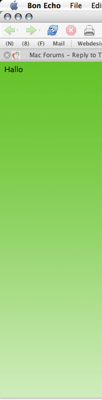

Now I just made a simple background in Photoshop, 20 x 1000 px, and used the gradient tool with some random green to white. Then used the "Save for the web" and saved it as a gif with 256 selective colours. That's this file:
Then, when I use the same code as above the background gets fairly smooth:
