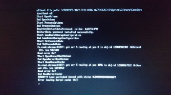

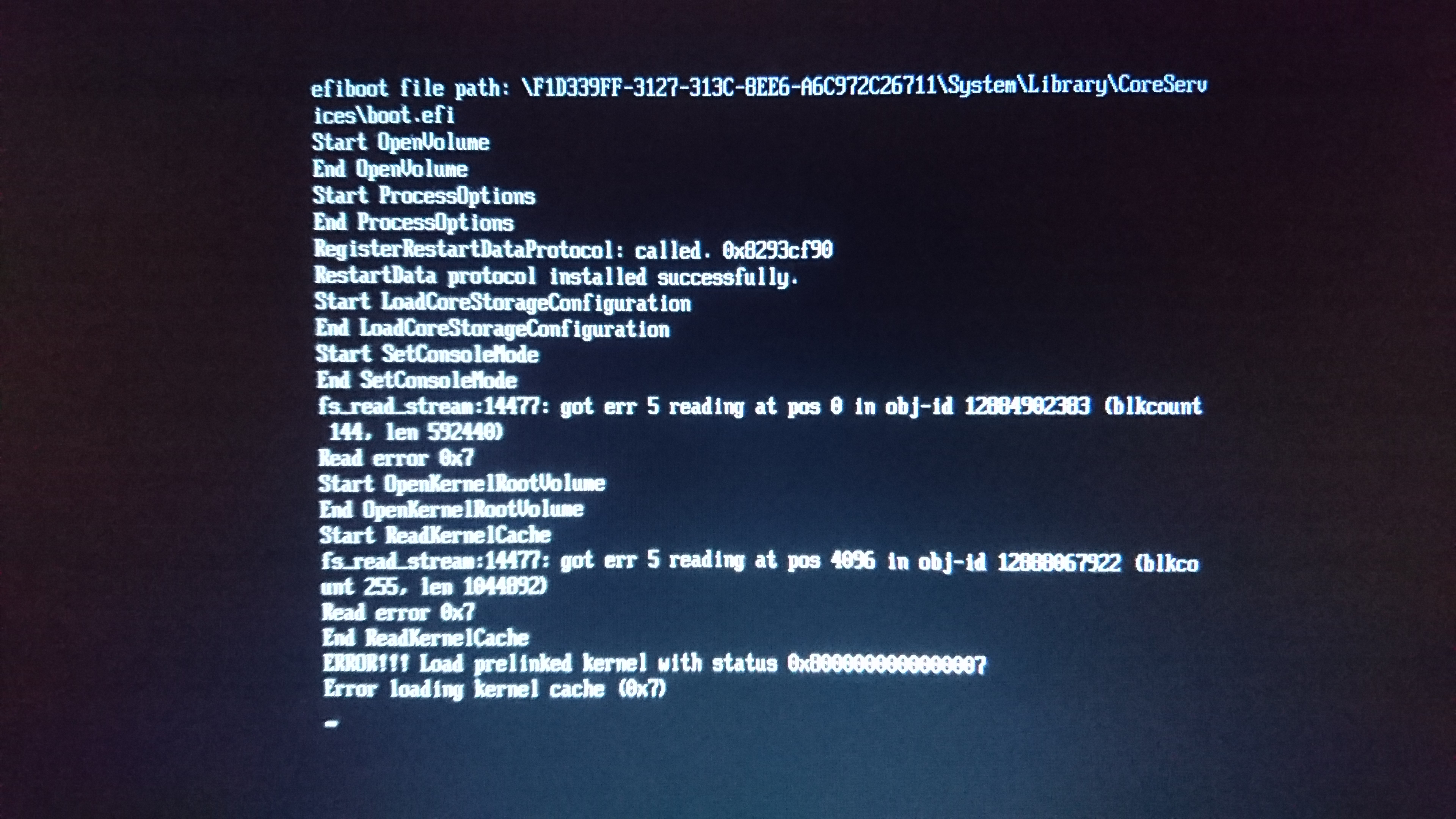

In verbose mode I get these messages during the time it tries to boot:
Right after a crash I can't boot to normal recovery, it directs me to internet recovery instead. After I have booted once normally I can boot to normal recovery just fine. There I have done first aid on the disk and it checks out ok.

The boot log shows 2 separate read errors when loading kernel cache. I'd be looking at either a corrupt installation of Mojave (try a clean reinstall as suggested by @chipchen above), or a failing HDD/SSD. For te latter, i'd backup immediately, then run fsck / Disk Utility / Apple hardware Test utility periodically to ascertain the state of the SSD.
The boot log shows 2 seperate read errors when loading kernel cache. I'd be looking at either a corrupt installation of Mojave (try a clean reinstall as suggested by @chipchen above), or a failing HDD/SSD. For te latter, i'd backup immediately, then run fsck / Disk Utility / Apple hardware Test utility periodically to ascertain the state of the SSD.

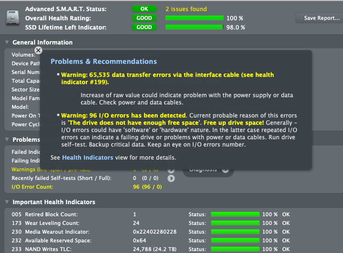

That makes sense, you also can download and test for 15 days free of charge DriveDX - this gives you a precise statement on the status of your hard drive. Please post the screenshot here.
So 65,535 data transfer errors and 96 I/O errors... I'm not sure exactly what it means but it seams like a lot and both descriptions also suggest the data cable.
I will definitely order a new ribbon cable! So strange that a physical part can be worn out like that. Thank you all!
