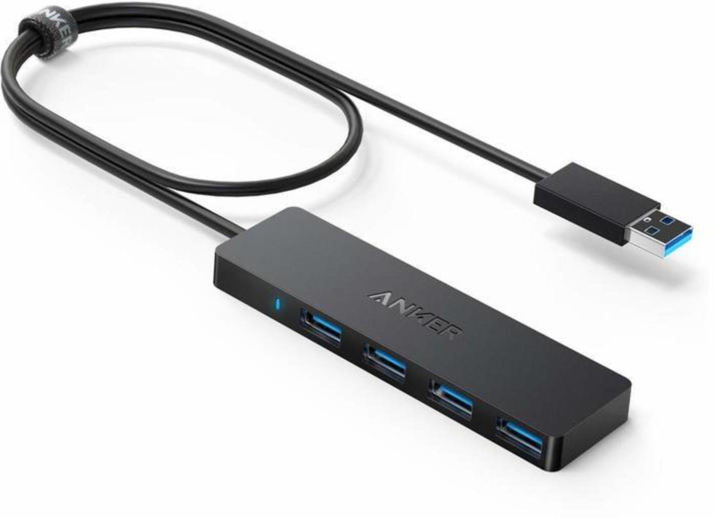

Edit: I could just get a USB3 hub and get it over with, but it will become obsolete when I move on to a new silicon MBP 16" some time next year. I figured a simple TB - TB3 cable could do the trick and be cheaper?

How about this one?
