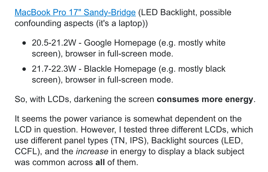

lots of discussion online, and opinions. but are there tests to show this? ie running a black background all day vs a white background? there is evidence that it matters on phones (etc) with OLED screens (where, in fact, dark mode offers more battery life).
Exactly the intent of the thread :). It appears to consumes more power in theory. Just wondering if there is any practical testing that anyone has done.
Edit: found this.
[doublepost=1541956474][/doublepost]CF21EB7C-891C-411C-8F77-C30A7E38A422.jpeg https://electronics.stackexchange.com/questions/30541/lcd-led-panel-power-consumption/32018#32018
Dated, obviously.
Ah! This is very interesting.
Since IPS LCD screens require the thin film transistors to turn on to generate the tiny electric fields to rotate the liquid crystal molecules that rotate the polarized light to allow it to pass through the front polarizer (i.e., become a white pixel), then these transistors in theory would use more power for white pixels than for black pixels.
On the other hand, an LCD screen still gets its light from the LED backlight, and to my knowledge most LCD screens leave the backlight on all the time. I'm no expert, but my suspicion is that the LED backlight generally uses much, much more power than the thin film transistors in the LCD panel, and thus it is really the LED backlighting that primarily affects the battery life of a laptop. This is why if you turn down the brightness of your display then your battery will last considerably longer. (By the way, this is true for both IPS LCD displays as well as OLED displays.)
An OLED display, on the other hand, each pixel generates its own light and thus dark pixels require much less power than light pixels. Thus for an OLED display Dark Mode would indeed save battery life since every dark pixel uses less energy to generate its light than every light pixel. So a predominantly dark screen will require considerably less power than a predominantly light screen.
Having said this, I'm curious as to the actual percentage change in the amount of light being emitted from a Dark Mode screen versus an identical screen set to Light Mode?
And finally, I worry about a crude test comparing two different homepages (Google and Blackle) in a browser at full-screen mode. Who's to say that these two different homepages were running the same JS code, same advertisements, etc? I'd much rather see measurements of the power on a freshly booted machine with nothing else running while comparing a white background image power to a black background image power. This would be a better test in my opinion.
