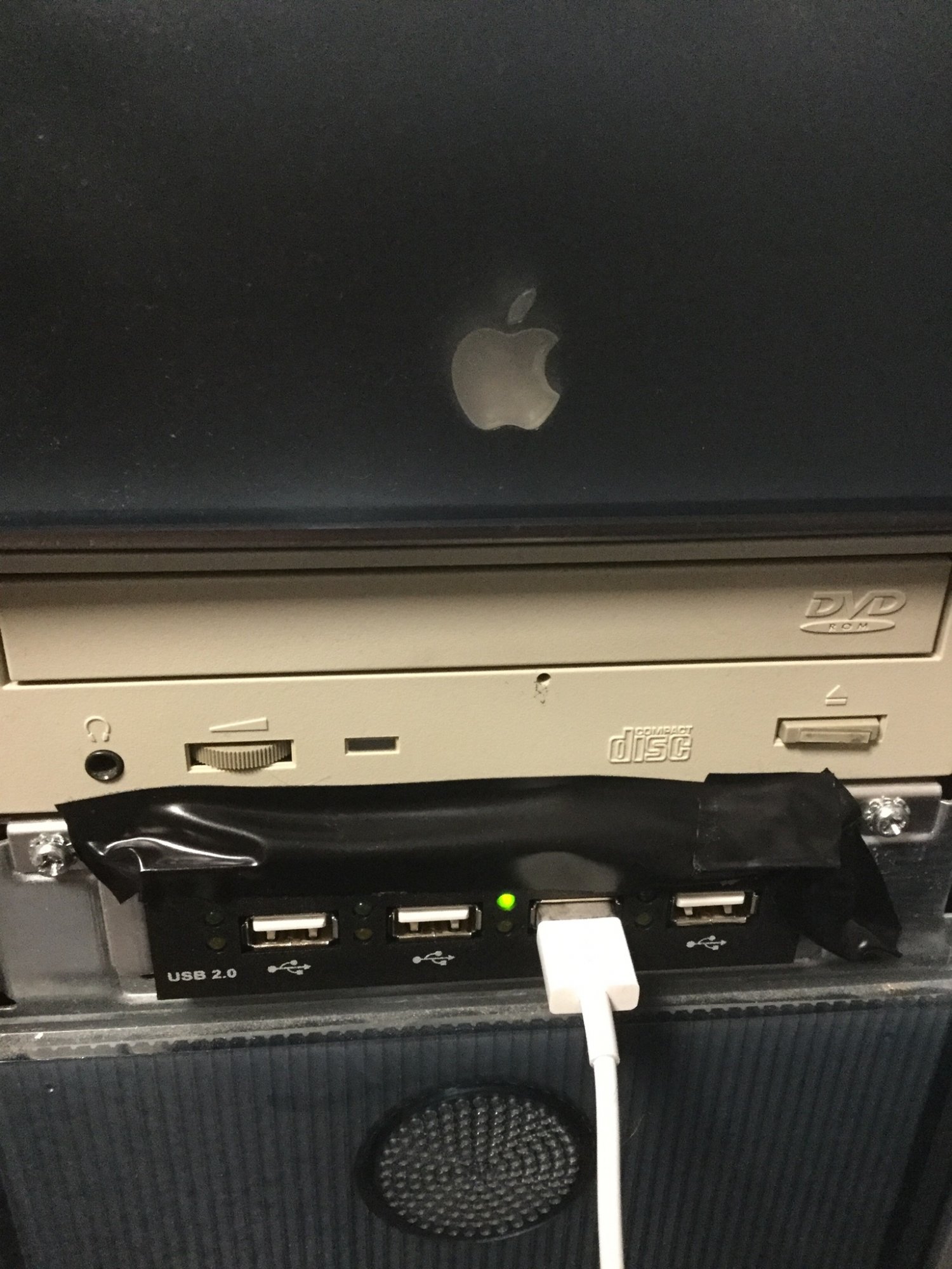

Well, so far so good on the USB Hub. Sorbet Leopard recognizes it without issue. I have tested out a flash drive and a USB DVD burner and the hub seems to be able to handle these just fine. It may not be the most exciting thing i could have put in the bay, but it seems to work.
Got a pic of what it looks like? :)
Here you go. It wasn't secured to the case when I first put it in, so I took some time today to screw it into the Sawtooth's drive bay. The screw holes on the bracket didn't quite line up with the holes on the Sawtooth's drive bay, so I had to enlarge the screw holes on the bracket. I used screws that I had stored away in a bag from other projects to secure the bracket because the included screws wouldn't fit. I noticed that the PCB board was exposed after I screwed the bracket in, so that's why I have the electrical tape that you see in the photo.
