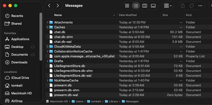

It took a moment to figure out that like Windows, certain system folders are hidden by default and I had to enable the ability to find the Library folder. Question - can I just delete the entire Messages folder, or is it preferable to delete the folder's contents. I think this is the right place:

The way I would have suggested to do it was to go to your apple account in settings (the one with the photo at the top) and find icloud there. Then you switch off 'use on this mac'
You have however, signed out of icloud so you can safely delete messages on the mac without it affecting anything on your phone or anything in the icloud.
But if you turn icloud back on again it will synch messages again. It's changed a bit in recent OS I think, it used to ask you if you wanted to merge them, now I think it just downloads them again but in any case, if you don't merge them and if it downloads them then it's not going to do anything to icloud or your phone.
It remembers the settings before you signed out of icloud you see. If you switch off messages you can sign back in and it won't synch them but with it left on, it will.
If you want to try again you can in fact leave icloud on but just disable messages and then delete them.
I can't answer about the enclosing folder.

Nonetheless, I also turned off Messages in my Apple account in addition to signing out from the app itself. Turning it off did not remove any of the files, so I deleted the contents of the Messages folder - that seems to have worked without mucking anything up and I reclaimed the storage space. I checked what happens if I open the Messages app and it asked me to sign in but no observable issues or errors. Opening the app did add a few system folders and files, but nothing of any size consequences. So it would appear that I'm all set now.
