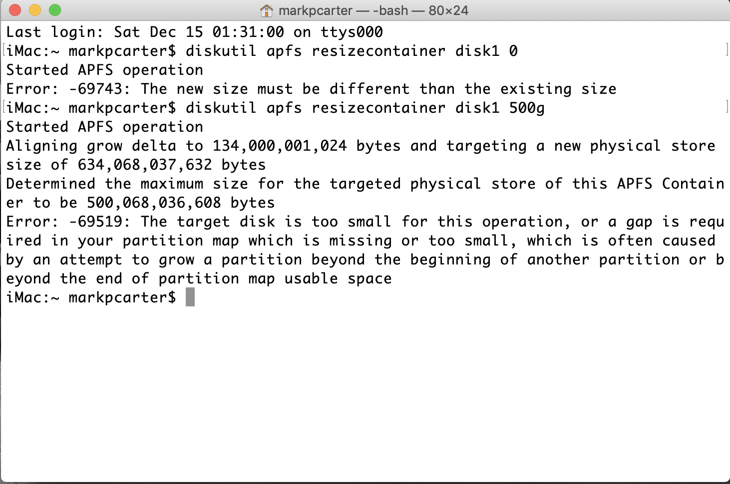

I've tried this on on disk1 with the size zero (to grow to fit) and with size 500g and neither work unfortunately - see terminal screenshot:
What am I missing?

Thanks BionicMan for this - I've tried to copy this for my situation but doesn't seem to work / think my issue is slightly different as my Diskutil list output is different?

Fisherrman / Bluedog314 thanks for ideas. I've been trying some other solutions but seems like a full erase and restore is going to be the way forward.
