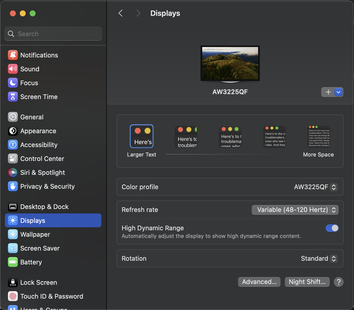

I got the same setup: AW3225QF and MBP M1 Max. But I also added a DisplayPort KVM switch so that I can hook up the monitor thru DP cable and it gives me full VVR and HDR capabilities, also spare the HDMI port for Apple TV and Nintendo Switch :D
Which kvm switch did you use?
it's Cable Matters DP KVM, I use it to switch between MBP and Alienware desktop pc. Fully 4K @ 120Hz (or VRR up to 120Hz) and HDR support. (Also I connect a second 4K monitor directly to MBP and it gets 95Hz, 3 years old M1 Max still rocks!) Works perfectly with eARC speakers thru the eARC port on monitor, in this case I got SONOS Beam 2 with Dolby Atmos audio.
