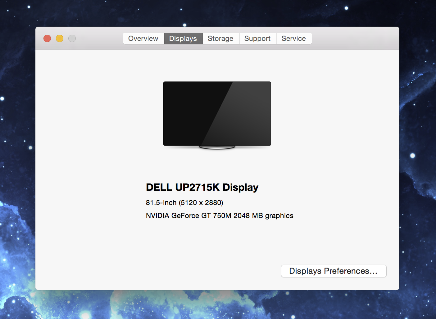

Did discover one funny thing: my MBP thinks the UP2715K is an 81.5-inch display, with and without the TB2 dock inline. See attached screenshot.

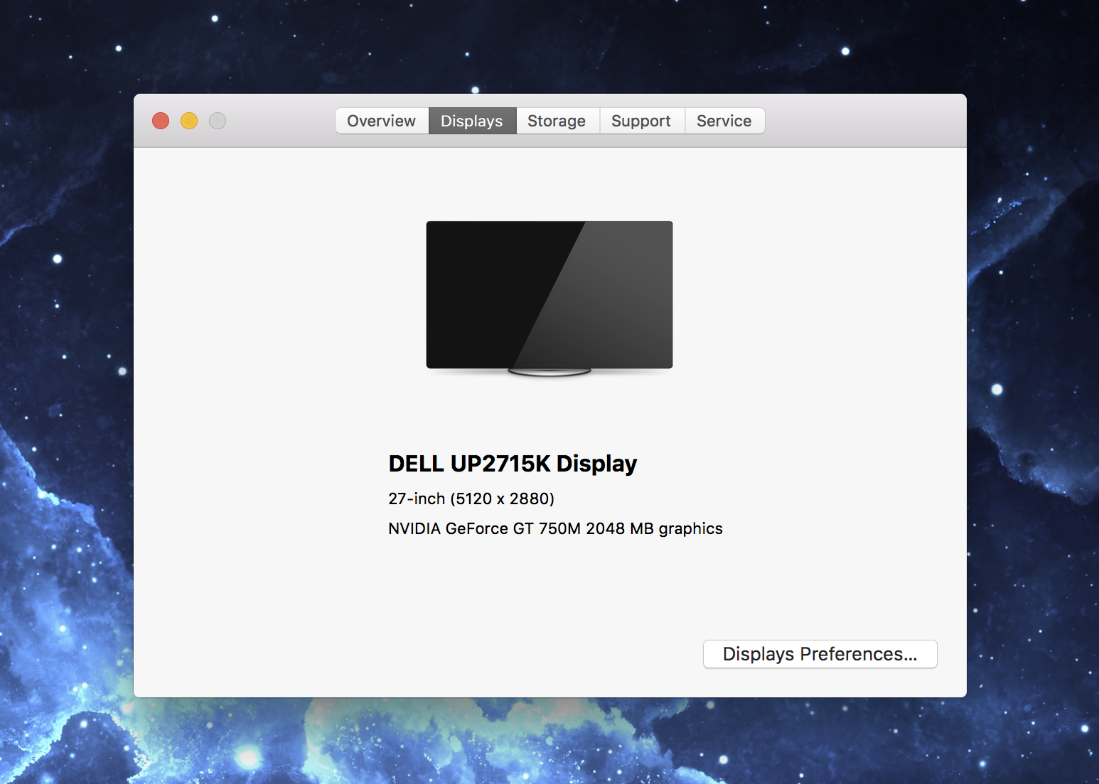

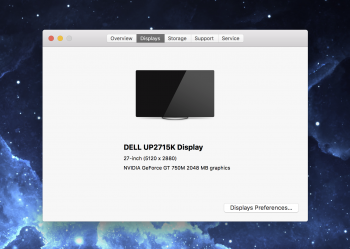

El Capitan update (same machine, same monitor, same TB2 dock per my original post):
After upgrading to the 10.11 GM seed, I now have audio over DisplayPort coming out of the monitor's built-in speakers, with one of the two mDP-to-DP cables plugged directly into the rMBP and the other plugged in to the OWC TB2 dock. OS X won't control the volume (i.e., keyboard keys don't change it, you have to use the hardware buttons on the display itself).
The monitor seems much better supported in 10.11 than it was in 10.10. I haven't had any of the "USB devices are using too much power" warnings yet, and the monitor immediately jumps to life when connecting my rMBP. It's a noticeably smoother experience all around. Furthermore, OS X now properly recognizes the display as a 27" display, rather than an 81" one.
