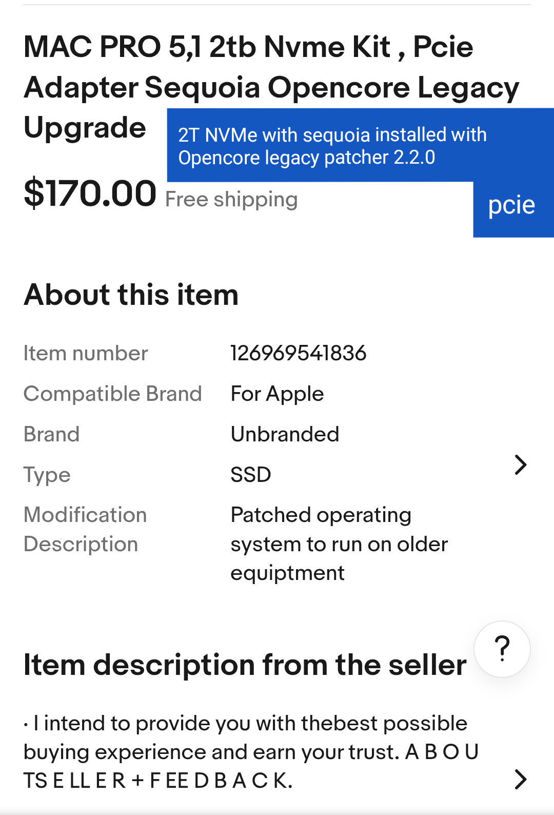

Bricked behavior began as soon as this was installed.
The instructions said:
Pull out all your drives. install the nvme in the top pcie slot. hit the power button.

The best moment of hope orior to actual salvation came in a note from the vendor providing the new drive. He wrote:
"You computer is not a brick. I have been working on computers for 160 years, and I am here tot ell you, there is no Mac that open has bricked EVER!,"
