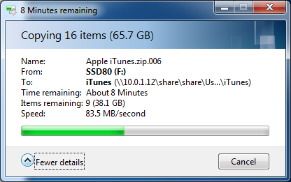

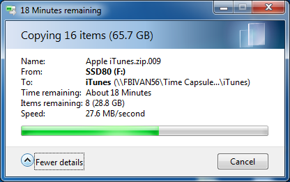

I'm sort of in the same boat, I just picked up a TC today and was testing it out. The router/wireless portions are great. The internal disk performance sucks as far as I am concerned. I was hoping the disk with a TC being SATA inside and connected to gigabit would be far better than something attached via USB2 but it really doesn't look like it. With the performance this is giving me I think an Airport Extreme with a disk attached via USB2 would be about the same.
Transferring 27gb in 16 files:
From my computer to my server I can get 83+ MB/s for transfer to it. Admittedly it is a beast with a PERC6i and eight disks in RAID6 over gigabit, running an Atom D510. Gigabit is the limiting factor here.
The time capsule didn't fare well at all with the same files pushing from the same computer. 27MB/s.

Check what?
Source files were my itunes library zipped up and split to DVD size that were stored on an intel 80gb G2 SSD. Same files for both tests.
Transfer to server:
Transfer to TC:
