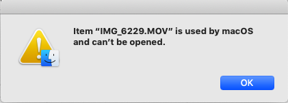

Today I tried to copy some videos from my mac mini to one of the hard drives and two things happened. The first is that the files started to take too long to transfer and after a few minutes the message "disk not ejected properly" appeared.
When I turned the docking station back on, I noticed that the files I was trying to transfer appeared on the external hard drive with a light gray description. While trying to access the file I saw the message below.

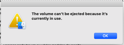

When I tried to eject the hard drives, another message popped up.
Should I buy another docking station??
