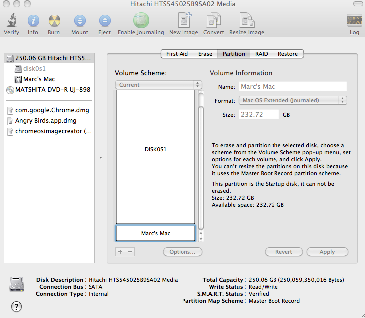

Hey guys, so today, I tried deleting some linux partitions on my MBP to free up some space. Sounds easy enough right? Well, the - sign which lets you delete a partition couldn't be pressed. So in Disk Utility, I erased the linux partition and from the dropdown menu, selected Mac os journaled instead of MS DOS FAT because i figured it would let me remove it. Well, :mad: instead it decided to get rid of the other three linux partitions, and combine them into the one i just DELETED and give it 250 gb or so of memory. While it gave my mac parytition 132 gb or so, and in the picture below, it also said it had 132 free, indicating that my mac is empty, yet, my mac files seem to be fine. However, I havnt restarted my computer yet, and I'm afraid if I do it will delete my files. Any suggestions? :(

Not sure what you mean, image below of my view in disk utility.
Ah, your Mac OS X partition is at the end of the HDD.
If you want to combine the Mac OS X partition with the big "DISK0S1" partition, you need to use an external HDD, properly formatted*, to clone your current Mac OS X partition to, boot from that external HDD, open Disk Utility, format the internal HDD properly*, and then clone the now external Mac OS X partition back.

Thank you. But did it delete my mac? Why did it give the partitions more gb than my HD has!!?? Is there any other fix? I just want to get rid of the goddamn partition that isnt my mac. ANY OTHER FIX-I probably dont have access to an external drive.
No, it not delete "your mac", meaning your Mac OS X partition is still intact, as you currently use it to make the screenshots and used Disk Utility to delete one/three partition(s).
If you want to get rid of the partition, "that isn't your Mac", meaning the partition titled "DISK0S1", I guess you want to combine that partition with the "Marc's Mac" partition (which houses "your mac", meaning the Mac OS X partition).
If you want to do that, you need an external HDD.

I don't know how it looked earlier, but I guess not, as the Mac OS X partition is at the end of the HDD. It normally is at the beginning of the HDD.
If you want to combine the two partitions, as mentioned before, you need an external HDD. Do you want to combine them?

Then you probably have done something wrong. I formatted and partitioned several dozens of HDDs several times in my life (at least a hundred times), and I could never delete my boot volume, the one I am using Mac OS X on and use Disk Utility with.
You have ****ed up your Mac before all this. You somehow installed several Linux distributions, which somehow made the Mac OS X partition end up at the end of the HDD (which still confuses me, unless you put it there after you installed Linux) and then you have deleted the partitions and ended up with one. You obviously ****ed up the partition map scheme.
But since you don't have a backup, clever for a guy having three Linux partitions (and probably three distributions as well) and one Mac OS X partition on the same, you are now royally ****ed.
Or not.
Since you may be proficient with Linux, have you tried gParted yet? It can repair your partition table, if that is the cause of your troubles.
If that ain't the cause, your data is still on the HDD (which you might know), thus you should stop any reformatting or erasing steps with that HDD.
Try gParted and see, if that helps.
