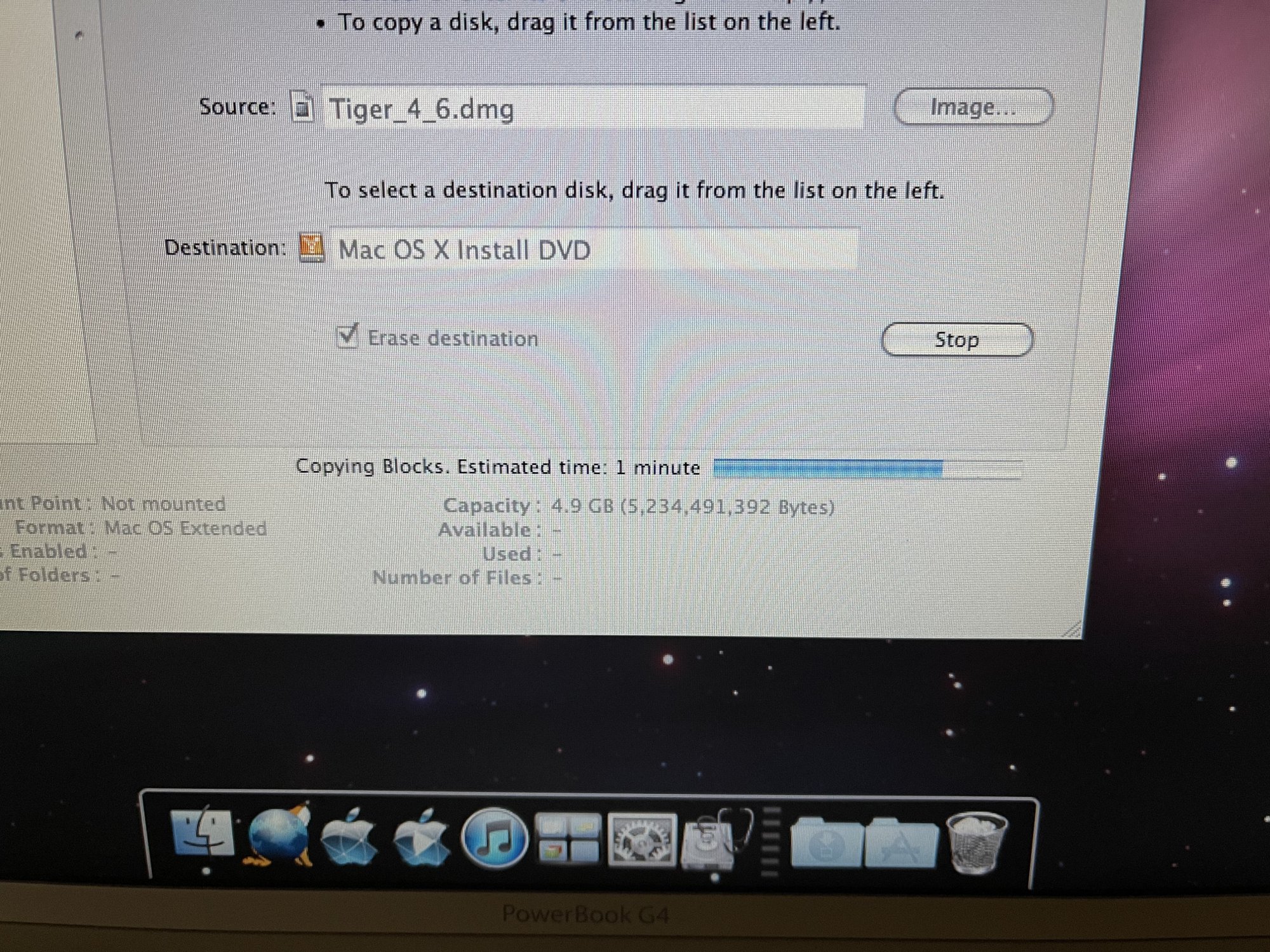

Up to this point, all of the work on the drive had been done by my 667MHz TiBook running Tiger. I've been meaning to put a new installer partition on that drive with a 10.4 installer and decided to do it with my new AlBook running Leopard. Creating the new partition went fine, and I used the restore function with a Tiger dmg file as the source and the newly created partition as the destination with the setting to erase the destination turned on so it did a block by block copy. Note: the following photos are from a later recreation of the problem so the names/number of partitions is not accurate.
The copying blocks part went along like usual, but at the end of the verification part, it seemed to hang and then I got an Restore Failure error saying the operation had timed out.

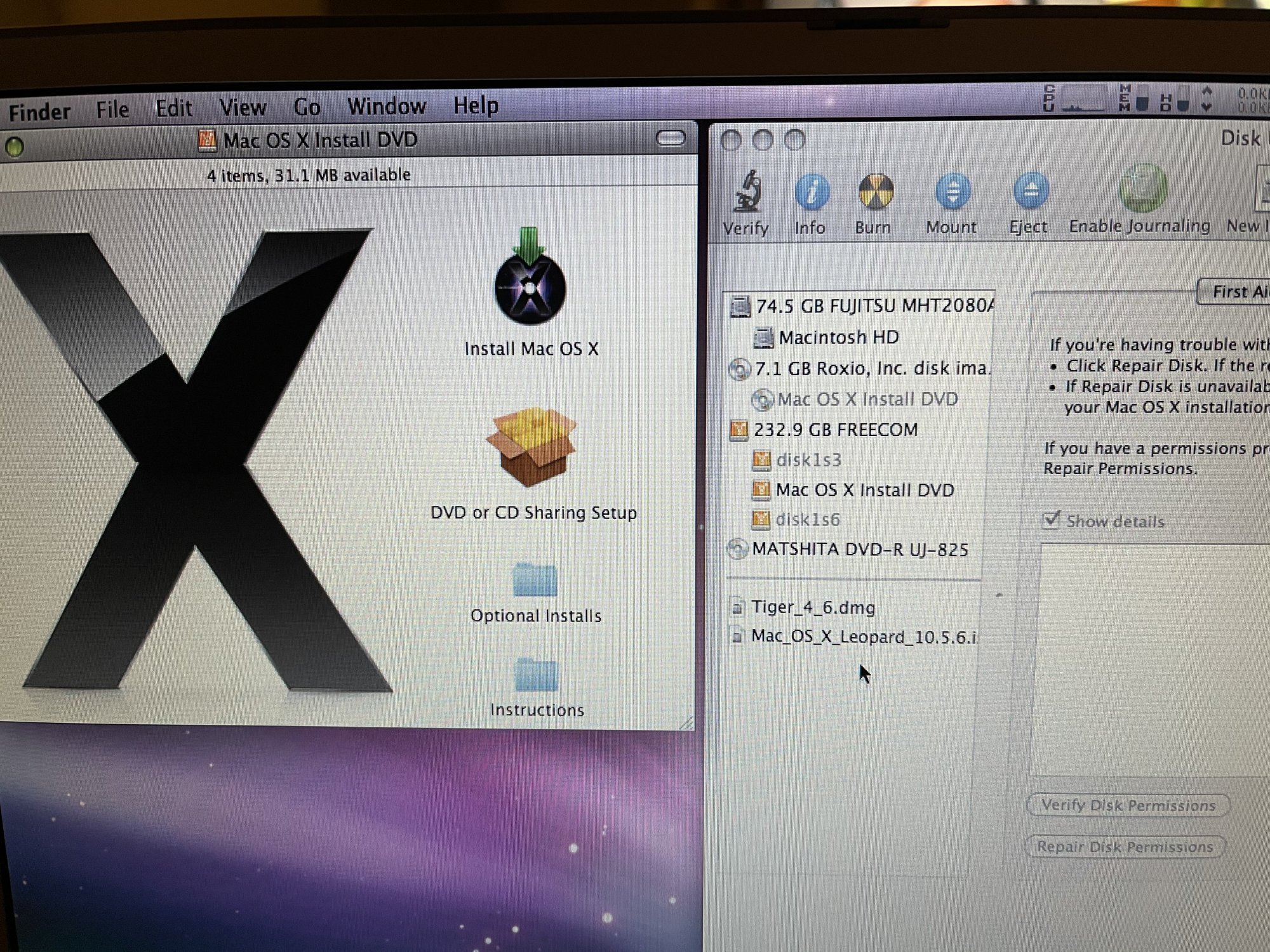

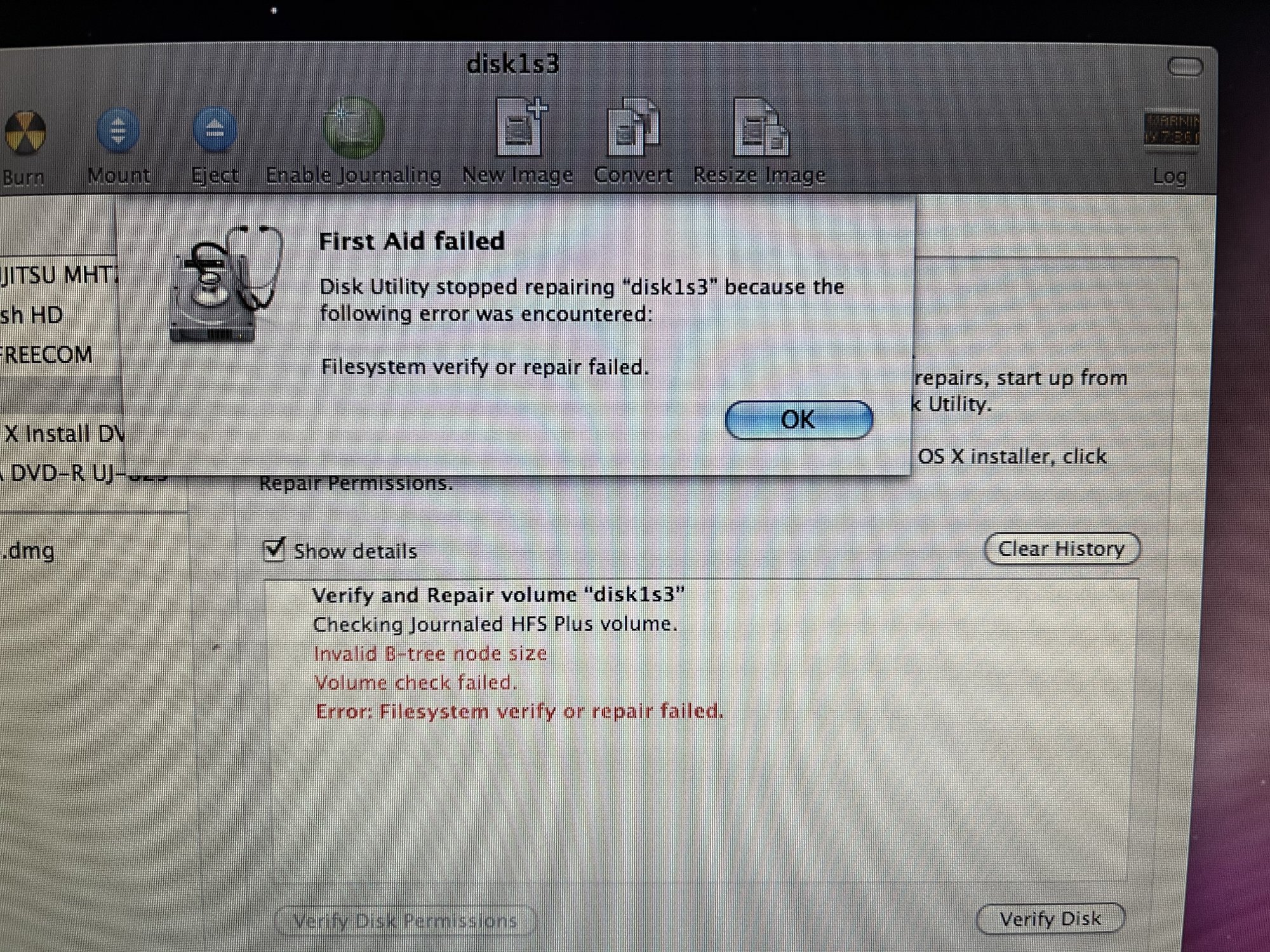

At this point, none of the drive was accessible, so I ejected it and plugged it back in. I got an error on screen saying the drive was not readable by MacOS and it prompted me to open disk utility to repair it. All of my partition names were gone in disk utility, replaced by generic "disk1s2, disk1s3, etc". I tried mounting the disk and got an error saying they needed to be repaired, so I tried that and got the following error:
Plugging the drive into my TiBook produced the same errors, with all partitions being unrepairable. Luckily, all the files that had been on it were backed up online, the various OS disk images could be redownloaded, and it would only take me a few hours to get it all set back up again, so I figured I'd just erase the entire drive and try again. First thing I did was try to create a 10.4 install partition again on the AlBook to see if it would happen again, and sure enough it failed in the same fashion. I was pretty convinced the drive was dying as it was over 10 years old and I couldn't think of another reason this might be happening. Just for fun, I tried it on my TiBook with the exact same dmg and to my surprise it worked perfectly. I erased it and did it a 2nd time and it again worked just fine. So I went back to the AlBook and tried again (this is when I took the above photos) and it failed in the exact same way, again corrupting the entire drive. So now I'm stumped as the drive doesn't appear the be the issue.

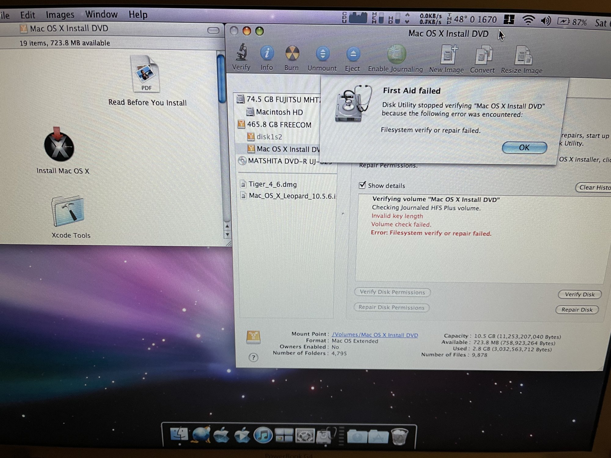

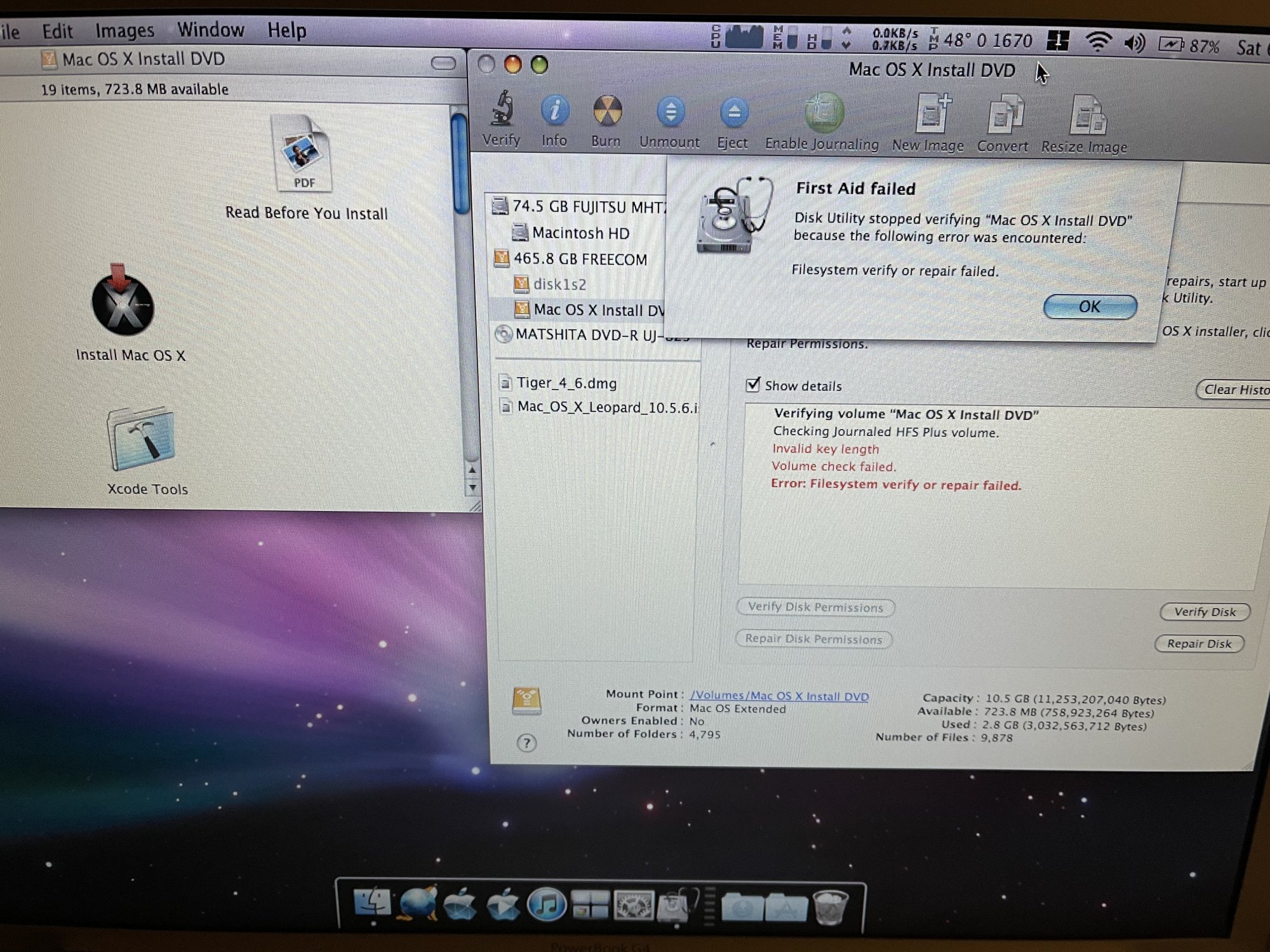

As an experiment to see if the tiger.dmg file I was using is somehow the problem, I tried the same with a leopard ISO file. Predictably, the same thing happened. The verification failed and then the disk was inaccessible. Strangely, after ejecting and plugging it back in, the Leopard installer window popped up and disk utility recognized that partition on the drive.
As you can see however, the other partitions are damaged like before. I tried verifying the installer partition that appeared to have been made successfully and got this:
I'm even more confused now than I was. I really don't get what it is about Leopard's version of disk utility that causes everything to break. All of this stuff works just fine on Tiger.

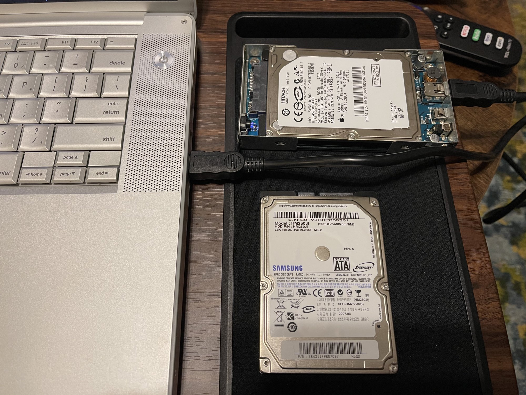

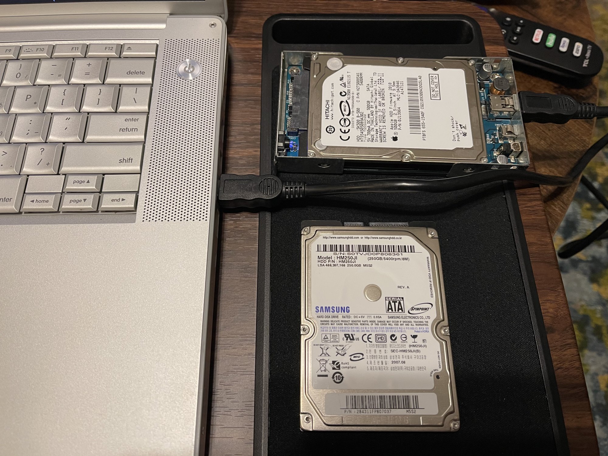

I probably should have checked for an update on this thread earlier. It would have kept me from pulling my hair out for the last 3 hours.
In an effort to see if the drive really was the issue, I ripped apart the enclosure and replaced the original 250GB Samsung Spinpoint drive with a 500GB Hitachi I had laying around from when I upgraded my sisters 2011 MBP to an SSD a few years ago.
Predictably, it didn't change anything. Just a slightly different error when verifying the volume.
On the upside, now I've got a (probably faster) 500GB external with slightly lower power draw.
Guess I'll give CCC a shot. I never even gave other software a thought because disk utility on Tiger has always worked and done everything I've needed. Thanks for the info on OS 9. I never actually bothered to try that installer, just made it because I had an OS 9 CD laying around and figured it wouldn't hurt to have it on an external drive.
