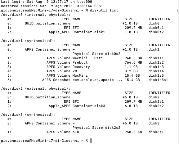

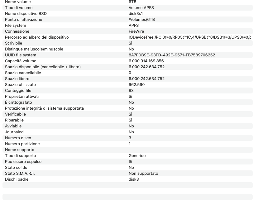

Long story short,
2 x 6TB drives off of my NAS since I upgraded it, put them into a LaCie 2Big connected via FW800 to MacMini 2014, of course it won't reckon the disks off the NAS, I formatted them one at a time and all went smooth, APFS, both into the LaCie case when I ask DiskUtil to create a RAID1 array it won't as it only sees one disk, the LaCie RAID utility doesn't work, it never did, it starts but doesn't find the drives, how can I fix this?
Thank you

These types of enclosures typically have built in RAID support. Check the user manual. Would not be surprised if there is a hardware switch that will flip between RAID0 and RAID1.
Reactions: benwiggy
Yes, if it's anything like my G-RAID, the OS just sees it as one disk, and the RAID is done in hardware on the device. As Bigwaff says, there will either be a switch, or you'll need a software utility to configure the RAID type.
Check that the Lacie app is up to date, or contact Lacie for support.
However.... this device is connected by FireWire? Presumably via an adaptor? Perhaps the newest Lacie app has dropped support for it.
You could test the device by removing each of the drives in turn, and seeing if you can read and write to it; and then what happens when you restore the missing drive.
