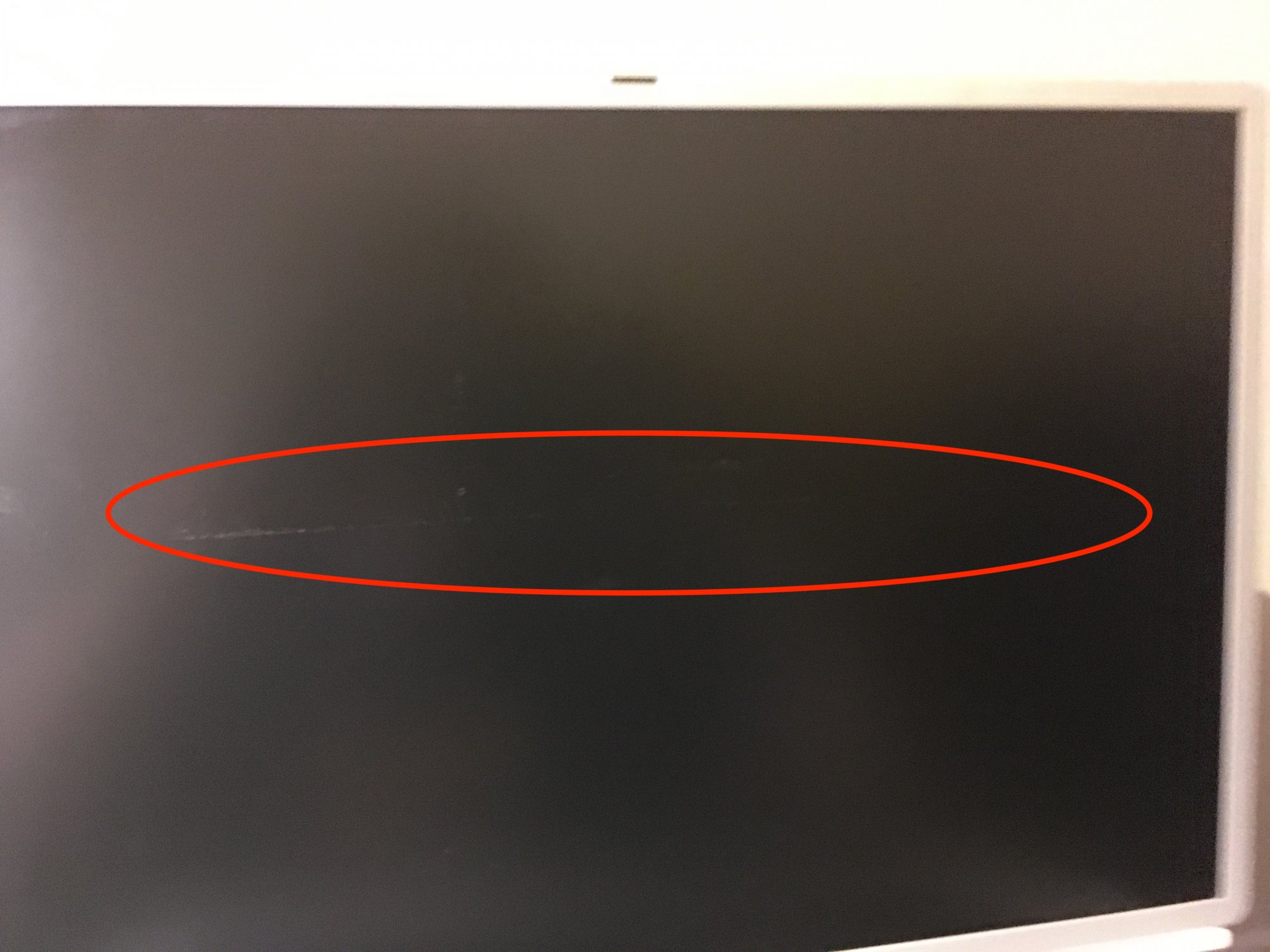

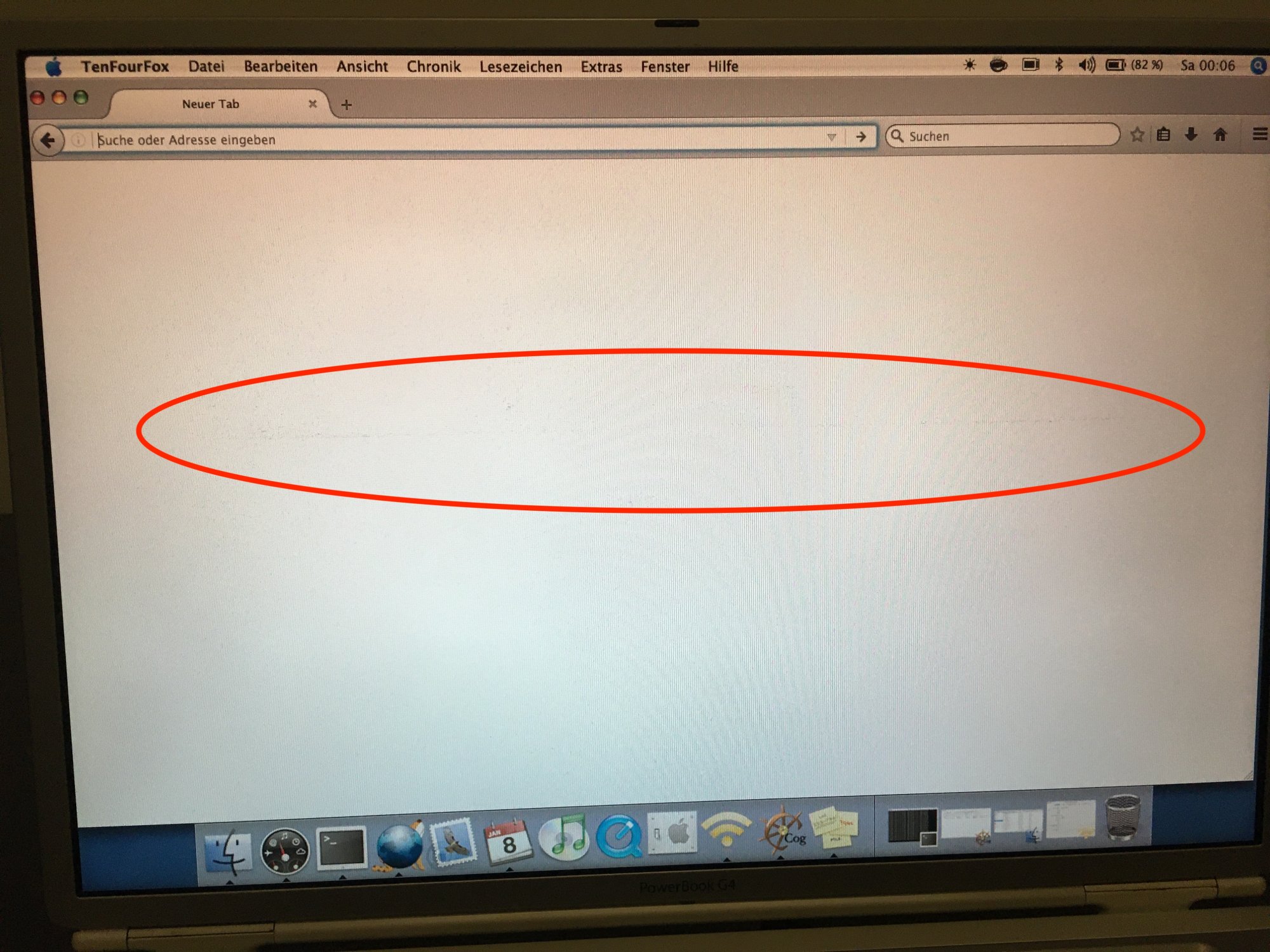

Good evening,
I have two PowerBook G4s Titanium A1025 (1 GHz) which I both rebuilt at the end of 2020 by using another donor A1025. I love them and when I acquired them both were inoperable which I fixed them with said donor. Since the rebuilt, due to lack of time, I haven't actually used them much, maybe once or twice in 2021 but earlier that particular year. Yesterday I had some tasks to do which can easily be done on a TiBook so I took one out its bag and booted it up. I noticed some stains (actually lines – 1 main line and a couple of small ones) on the screen that weren't there when I last used it. Initially I was thinking it is only dirt and I tried to wipe it off but they seem to have merged into the polarizer (as the marks can also be seen when the screen is off). Yikes! I tried different cleaning methods like glass cleaner, alcohol (very carefully of course) and dedicated TFT/LCD cleaning solutions but to no avail. I think the marks are from either the trackpad or keyboard as the marks correspond with their location. I took my second TiBook out to see if it shares the same fate and yes, kind of, although it isn't as bad, I can see a pattern here.
Even though the damage has already occured I now place a sheet of paper between the top case and the LCD in hope of preventing further marks. The marks are actually kind of annoying and I have to admit I'm kind of bummed ... I know those LCDs will soon reach the age of 20 and that nothing lasts forever so I can deal with it. Btw LTN152W5-L02 are bad screens from my experience, I have encountered so many flaws with them. I could probably fix my TiBook by changing the LCD but it most likely is a pain to separate the display assembly and I don't feel like swapping the panel since a) it will probably reoccur, b) requires to unscrew the machine and take out the logic board, c) immaculate screen replacements are hard to come by and d) time is precious. So I decided to just live with it (it is still better than vertical lines, bright spots and backlight bleeding) but yeah I'm not amused by it.
I'd like to know if I'm the only one to experience this or if this is/was a known issues with TiBooks. Also do owners of TiBooks in this forum exprience the same issue?

It’s not a “staingate”.
The scuffing is what happens with any Mac laptop whose design tolerances between closed lid and keyboard — and particularly evident on models whose keyboards have sharp creases at the corners (like all iBooks and all titanium PowerBooks, but not the aluminium PowerBooks or MacBook Pros) — are tight and pressure between lid and topcase are compressed, causing slow, but incremental abrasions, typically as when stowed away in a backpack. It’s most present where the bottom of the keyboard meets the display.
I’ve had this come up with iBook G4s and my titanium PowerBook, but not with clamshell iBook G3s (since there’s a bit more space between keyboard and display when the clamshell design lid is closed, coupled with its more sturdy case/clamshell). To some extent, contact between a display and keyboard on something like an aluminium PowerBook or MacBook Pro can and does happen (often, in the form of oils from cumulative typing getting on glossy displays), but since the “lip” at the corners of keys is much softer and curved, especially so with the space bar, the prevalence of contact scratching on the anti-glare sheet is noticeably diminished.
You can remove the LCD from the display bezel and remove the anti-glare sheet using a specific wet method I use for removing them on displays like my clamshell iBook and 20-inch ACD, but that’s if you want to have a glossy display. And the same tolerances and risk for scratching exists, but it can give your LCD a second chance at an unscratched life — especially if you find some kind of thin sheet (like the paper you described, or the foam-based sheets Apple began inserting in factory-new unibody MacBook Pros) to insert when the lid is closed and the laptop is being moved.

On my TiBook I have the same sort of stains on display. When I first bought the TiBook, there were no visibe or noticeable stains. They must have been formed when I opened the back casing of the laptop. In order to open the back casing, the laptop is typically lied on top of its display, causing the weight of the laptop to burden on the display. And while unscrewing the 8 screws, you must press on the screwdriver and that causes the sharp curves around the keyboard to rub even harder against the vulnerable LCD display. Of course, I didn't know that such a thing would happen when I opened the back casing for the first several times. So without knowing it, I opened and closed the back casing several times, only then did I notice the stains on display and realized that I myself have caused them :(
They are usually more visible in the morning sunlight. Not discernible at all at night. So I got used to it in time.
After that event, whenever I needed to open the back casing, I always put a thin clean nylon between the display and the keyboard and of course I didn't apply much force while unscrewing the screws. I'm okay with it.
