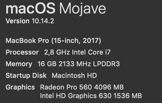

Which model Mac?
Which model Mac?

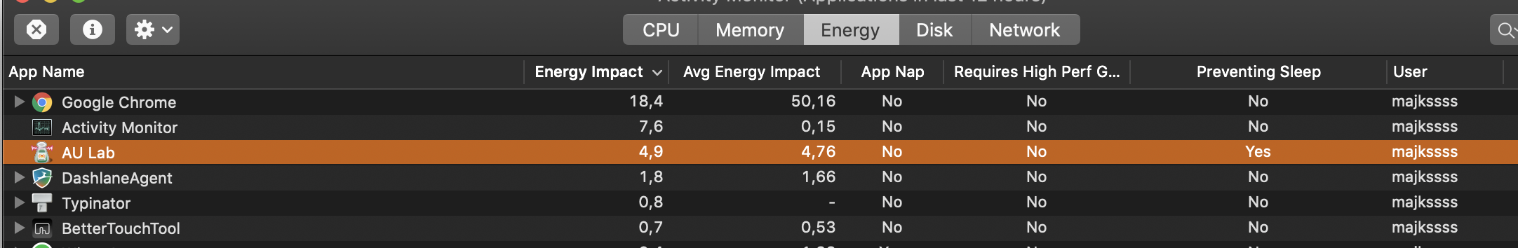

[doublepost=1548141647][/doublepost]ok, I found the issue lol.
If anyone else has this problem, check the Activity monitor, Energy tab.
