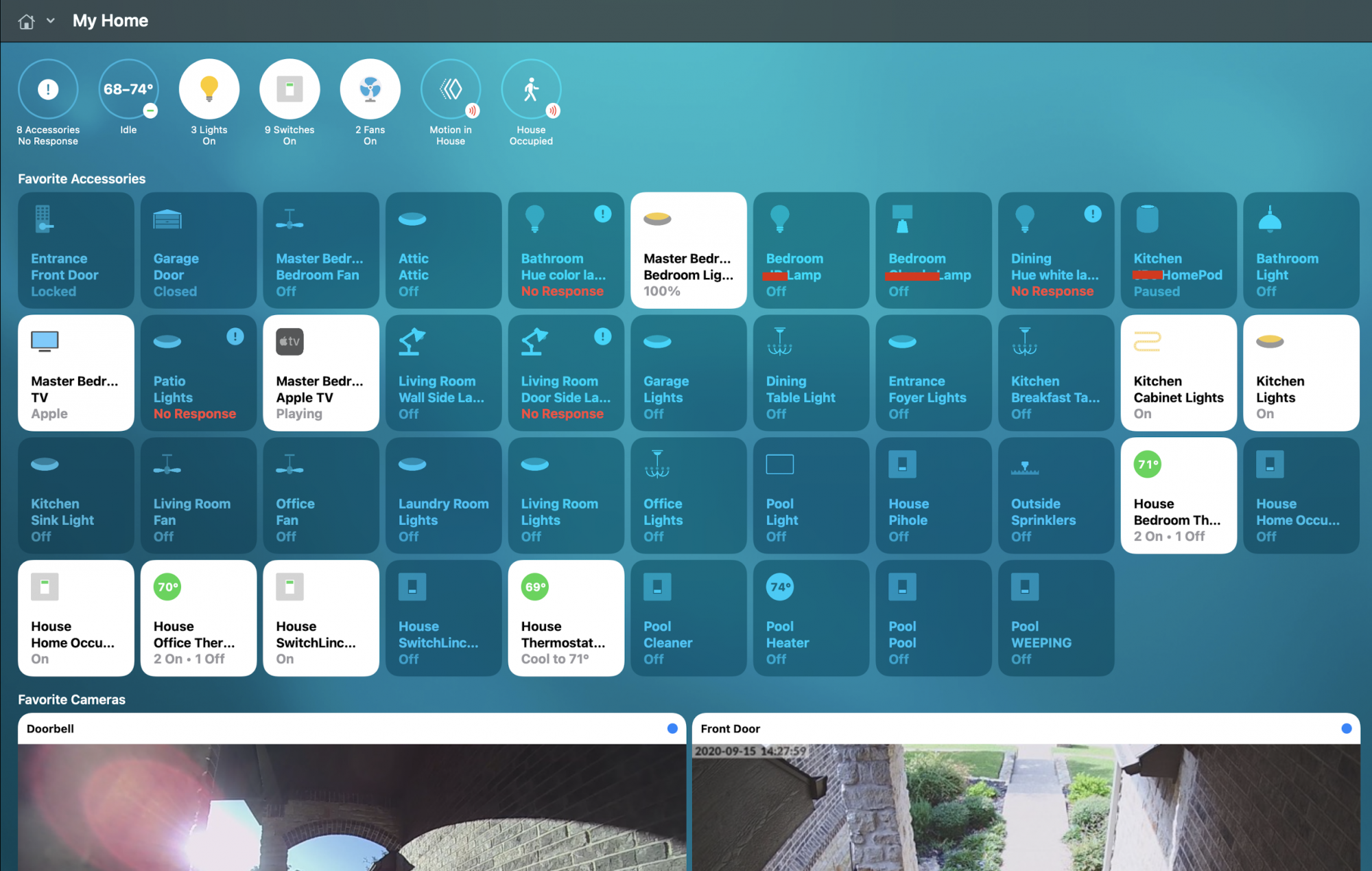

I had a Ring Doorbell Pro working on Homekit. It shows in all the Home apps, shows on the Apple TV's when someone rings the bell. All the things a supported version does.
I also have my Nest Thermostats on.
I replaced the Ring with a UniFi doorbell, cameras were already Unifi protect so it works out.
I already had an UnRaid NAS at home anyway. So in their "app store" is a HomeBridge with GUI app. Download and start it up and you go in that and search for pretty much any app controlled device and add to HomeKit through a single interface.
So I have much older Insteon switches, Nest Thermostats, my swimming pool lights/filler/heater, sprinklers, garage door, cameras... just so many things I've randomly got throughout several years all working together in a single app. The only things actually homekit supported out of I have are a handful of Hue bulbs.
The things showing No Response at the moment are a few bulbs that are connected by regular light switches. Most of the switches in the house have been swapped with controllable switches if the room has multiple bulbs.
