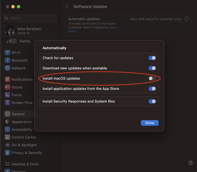

If you really need to rollback it sounds like you successfully installed Monterey from a bootable USB and migrated your data from TM, but then it automatically updated to Ventura. What is your setting here:
You could try repeating the process after turning the above setting to OFF, and making sure you have a TM backup made with it off and you are restoring from that.

Maybe try doing that and going quickly to the above setting...or turning off internet. Though as I said I would be surprised if the automatic OS upgrade kicked in that quickly

No, that isn't it. The only automatic upgrades I have turned on are security updates. I couldn't even reload Monterrey from Recovery Mode, it automatically tried to install Ventura.
