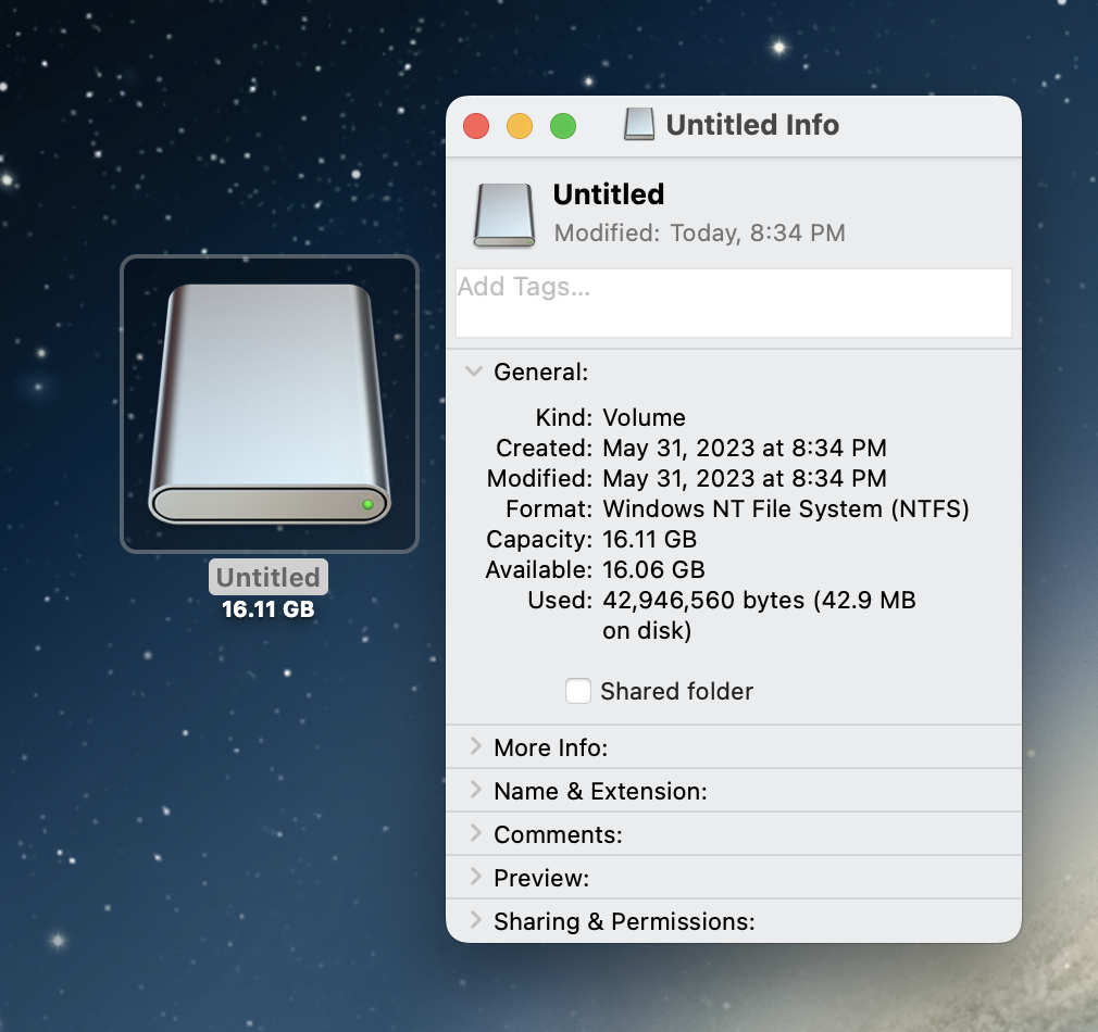

Works for me. NTFS drive mounted in macOS 13.4. ¯\_(ツ)_/¯

Just how did you do this, My nood in macOS is showing.😟 I went through this early on and there didn't seem to be a solution. I have about 7 TB worth of files to copy. I have the 14TB Seagate I want to put most of this stuff into. I tried it with a couple of SSD's and they would not mount. I have Seagate conversion software but have not tried it out.
