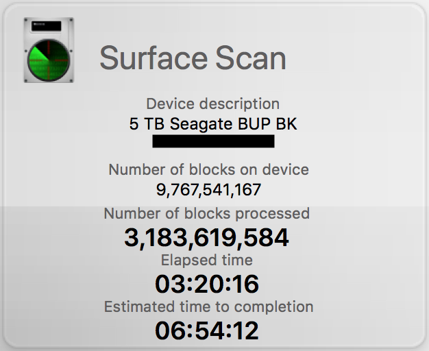

I use TechTool Pro 10 to scan disk surfaces for bad blocks
