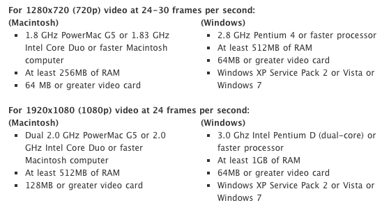

The details below are from Apple's QT Tech Specs Page.

*Apple does state that 720p with the 1.8GHz G5 suffice. What they failed to point out if a Dual 1.8Ghz G5 will suffice for 1080p.
