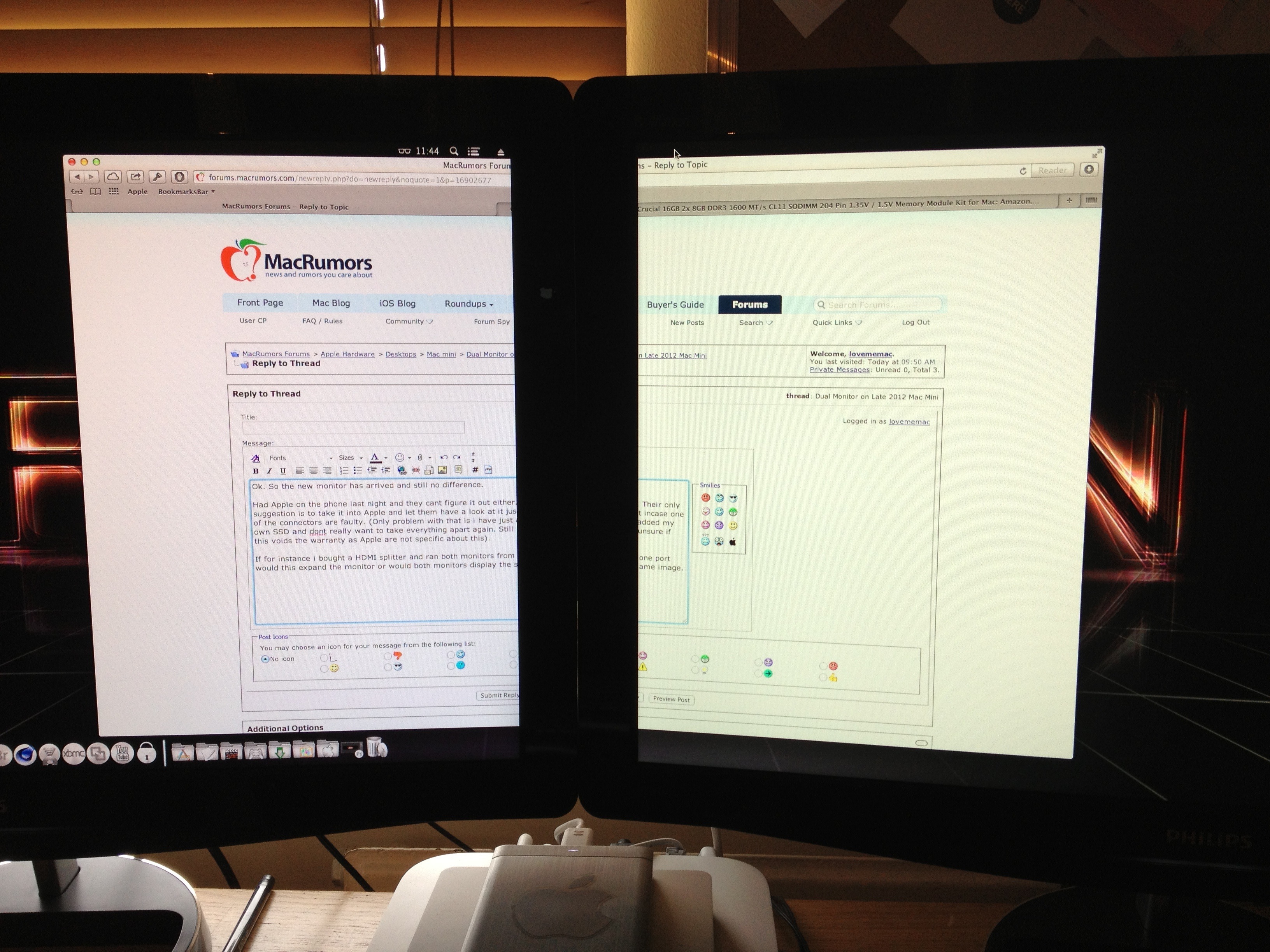

Hi all. I have recently purchased dual monitors for my MM set up. 24" Phillips Moda's.
The main monitor is run off thunderbolt to hdmi, the second hdmi to hdmi.
The second monitor is ok but the main one seems to have a yellowish tint.
What i mean is, if i open Safari and drag the page to the second monitor and stop between screens the main side is yellowish and the second monitor side is pure white.
There are loads of settings on the Moda and have tried to adjust them but the picture is still not as clear as the second monitor.
I have swapped the connections so i dont think it has anything to do with them.
Im just wondering if this is a common thing with dual monitor set up with the MM before i return the monitor as faulty.

Ok. So the new monitor has arrived and still no difference.
Had Apple on the phone last night and they cant figure it out either. Their only suggestion is to take it into Apple and let them have a look at it just incase one of the connectors are faulty. (Only problem with that is i have just added my own SSD and dont really want to take everything apart again. Still unsure if this voids the warranty as Apple are not specific about this).
If for instance i bought a HDMI splitter and ran both monitors from one port would this expand the monitor or would both monitors display the same image.

Buy the Apple MiniDisplayPort to DVI adaptor, and use that from the Thunderbolt port. Use the HDMI to DVI adaptor that comes with the Mini.
There do seem to be issues with HDMI. Unless you're actually hooking your Mini up to a TV, I wouldn't use it. (It reminds of the days when computers had a UHF output so you could plug them into your TV...!)

You could test new a user account, to rule out any user prefs or settings that are causing the issue. Otherwise, persist with Apple. You've successfully shown it's not the monitor.
But you've definitely installed this:
http://support.apple.com/kb/DL1616
Fixed my problem thanks.
True, I just experienced this with a crappy / cheapy AOC monitor. Worked fine on my MBA but not as a second monitor attached via TB on my mini (mid 2012). As the smart poster suggested I now have the cheapy AOC going from the HDMI out of the mini and my better VP2365eb Viewsonic on the end of the thunderbolt chain. Problem solved. Just need to then tell OS X that you want to make the TB connected monitor your main one and you're set.
