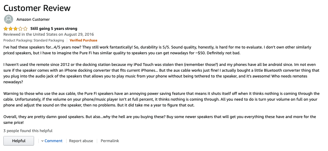

**** Sorted - version 2 *****
Oh man,
The sound cutting out started up again after a while!
I found the actual fix number:
1. NB: MBA > USB-C Hub > Monitor > 3.5 Lead to Sound system.
2. To Fix - Turn the volume up on the MONITOR to max.
3. I.e. The sound system shut downs, if it thinks no more sound signal.
4. Then later.... I found the fix, looking on the internet:
Would have been good finding this days ago! 😆
