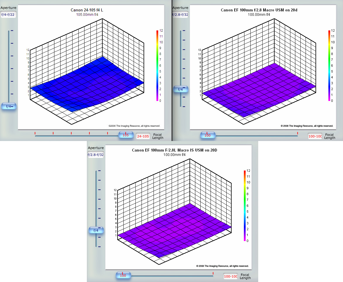

That's the week end of the 24-105. It's a convenience zoom that does very well for its generous range, but the extra range you get with it is a bit soft. Primes will of course be much sharper, as you can see from these SLRgear charts:
All set to f/4:
(Click to enlarge)
They don't have results for the EF 100mm f/2, so I've included the two 100mm macros (original model and new L lens). As one would expect, the new L version of the 100mm macro is by far the sharpest at f/4. (Lower and pinker colors are better. Raised blue means softer. The corners of each rectangular plane are the corners of the frame on an APS-C sensor. If you want to see full-frame, just choose that tab on the SLRgear.com site.)
