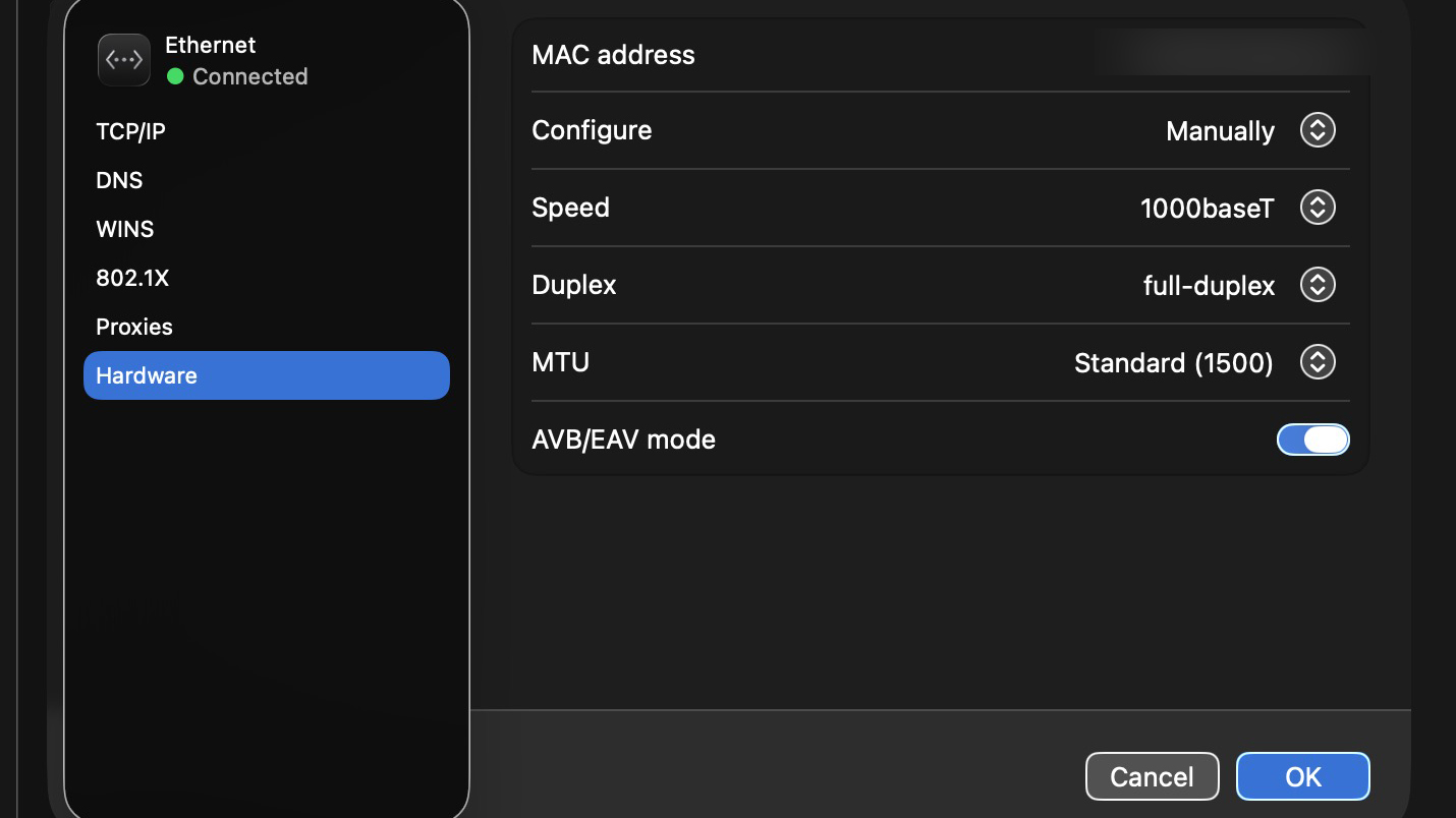

Maybe worth a try. Change Configure to Manually, and the Speed to 1000baseT if you have a 1GBit Ethernet port.
So I had my Mac at Apple's contractor twice, even replaced logic board. Ethernet worked fine for them.
I had to change settings to manually and now it works, no idea why I need this with my Vodafone router, and why I don't need to change anything if I use ETH->USB adapter.

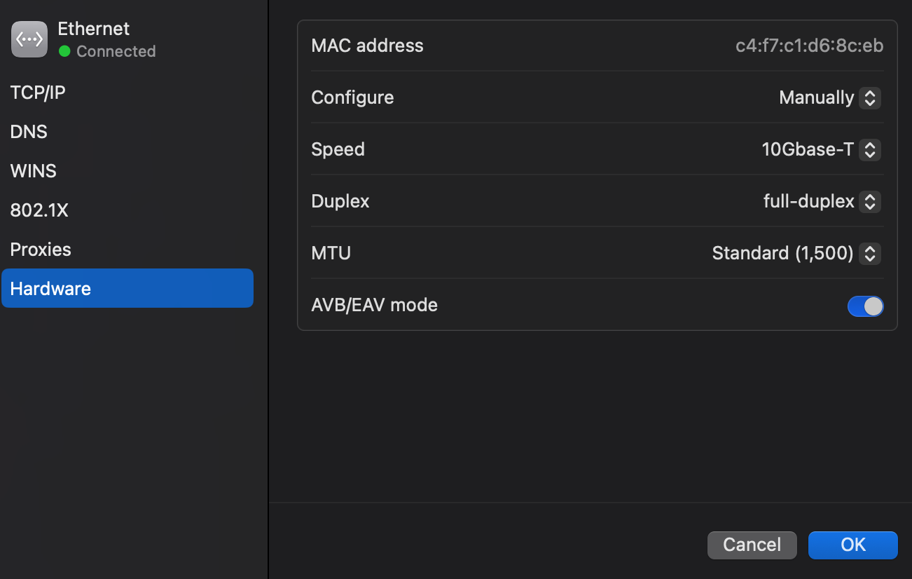

I always check the hardware settings on Ethernet. Often, I have to pull and reset the cable of a running Ethernet.

I remember from some time ago AVB/EAV mode being a problem with some ethernet adapters.
You might try to disable this setting and see if that changes anything.
