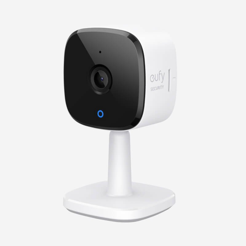

I have my Eufy Homebase 3 and Indoor Cam E30 fully setup on the Eufy app. All I want to do is record to Apple HomeKit HKSV as I have iCloud+
I have successfully added the Homebase 3 as a bridge to Apple Home. I have connected my AppleTV as a bridge within Apple Home. When I open the Apple Home app, I just see the apple TV but I do not see the Eufy Homebase 3? But if I go into settings -> Home Hubs & Bridges, I see the Homebase.
How do I initiate the recording to Apple HomeKit HKSV?
Sounds like the E30 needs to be added to homekit via wifi directly, and not through the HomeBase.
Just an FYI in case you aren’t already aware… HKSV will only record detected events; it cannot/does not record 24/7. I get the impression you want to do the latter, but I could be wrong.
If you want 24/7 recording so you can look back at something that might have been missed, you’ll need to make sure the camera supports local recording in addition to HKSV. You then have to use their app to play back the non-HKSV recording. I know the Eufy cameras can do this, but I’m not sure about other HomeKit cameras…some do and some don’t.
