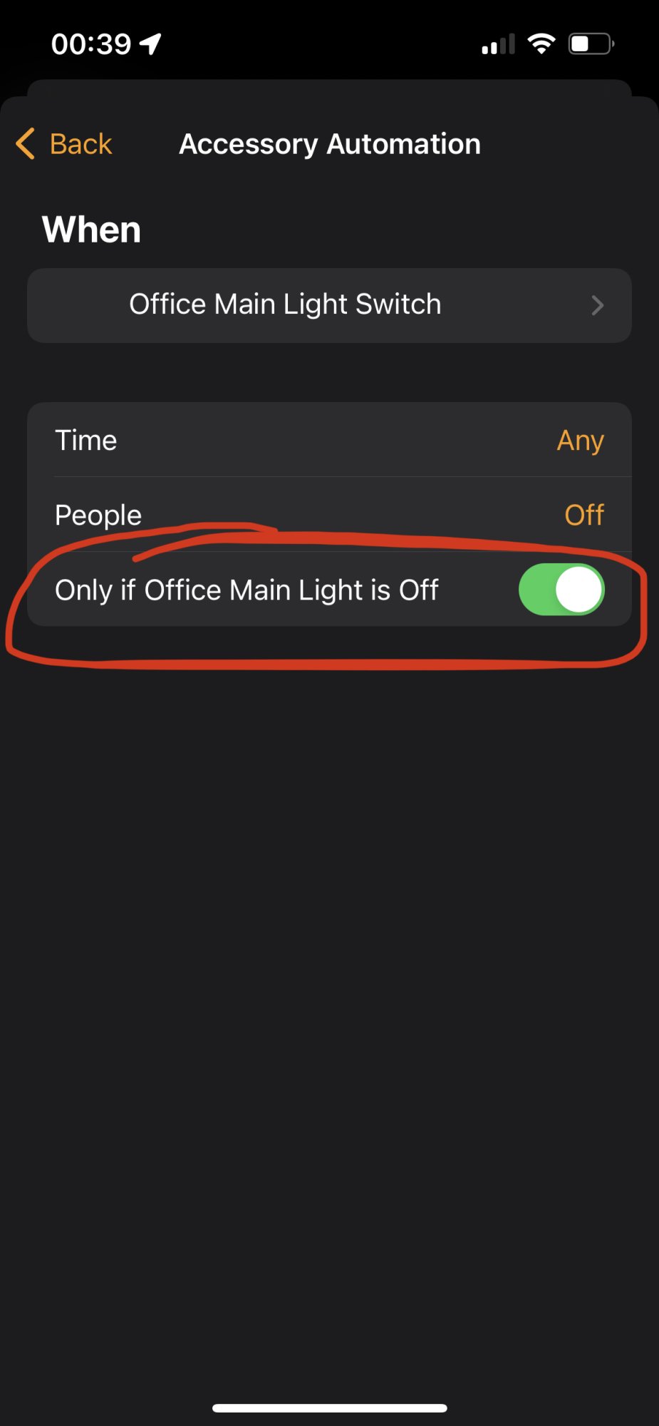

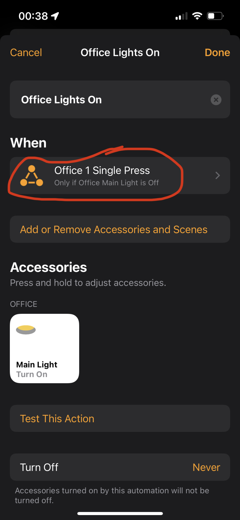

Ah ok, so I figured it out…
These automations I was creating in the Eve app (which I also tried in Controller and Home+) were for LIFX switches. The switches have either two or four button configurations depending on which one you purchase. I wanted to save the buttons by having only one button control the lights to go on and off and use the other button(s) for scenes and such.
In the Home app, the button press actions are configured in the switch’s settings, not automations. However, in the Eve app and other apps, this is configured in automations/rules. Therefore, I assumed that if I set it up in the Eve app under Rules, it would populate in the Home app also as an automation. Not the case…
The Home app is actually smart enough to add this to the switch’s settings instead of automations, which I prefer to minimize confusion. From there, I am able to remove the scenes and add accessories a la carte the way I originally wanted. Even better, the Home app also realizes that there was a condition set from another app and actually labels it as such. Low and behold, upon further investigation as I type this, the Home app actually creates a toggle for the condition. Never noticed this before (see pics below)
No clue why I didn’t check this before but I just discovered it and my problem has been solved.
