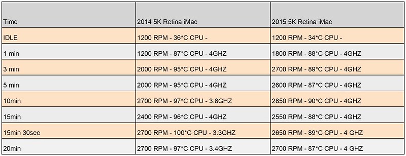

We know from actual testing the i7-6700K in the 2015 iMac 27 often hits 90C or a bit more and does not usually thermally throttle under that load:
Above from Max Yuryev test of 2014 vs 2015 iMac 27:
