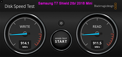

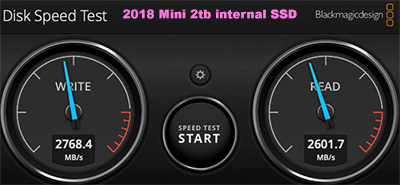

The only real insights I can offer are some disk tests. I have quite a lot of Samsung external USB SSD's, I use them pretty much the same way I used floppy disks on my Apple ][ 🤣
This is my internal SSD, but since yours is smaller, it might be a little slower
I ran my 2012 quad mini from a Samsung T3 1tb boot disk and it worked fine although it only clocked around 400MB/sec. But the original internal Apple 256gb SSD was only about 500 MB/sec on that Mac. I'm sure the 2018 will work with a T7, but there's quite a performance difference. Would be reluctant to do that myself, but I guess you'd just have to try and see, might be fine.

That is a pretty big (by numbers, anyway) difference between int and T7.
But since I've created a bootable b.u. with CCC on a spinner I have and that worked fine (although took forever to get there) I will prolly get a T7 and make a bootable Monty on that with PT. If it's reasonable, it won't just be my b.u. but Monty drive for PT and update the mini to Seq again.
