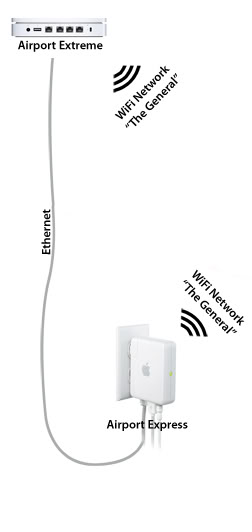

My end result should be this:
http://i189.photobucket.com/albums/z201/paloooz/network.jpg
The "wifi barrier" would just be the fact that the red line is like 300 feet wide.
300 feet of distance, the Airport Express has like no reception with the Airport Extreme.

It will work, I've done it in my house. I would make it flash if i could since you missed it in my first post.
It's how businesses are able to cover large areas.
My setup was even used a linksys router and an airport express.
you wouldn't want the macs to be the same, the wireless client (laptop) would get confused as to who it was talking to.
Plus this way if someone is on the north side, and another on the south side, they don't interfere with each others wireless bandwidth.
Just make sure that.
1. The airport express is in "off (bridge mode)" - this will fix the problem of the express being it's own lan. it will even then let the extreme handle DHCP
2. The SSIDs are both set to the exact same thing "The General"
3. Wireless security settings are exactly the same.
4. Channels are different. preferably, spaced out so they don't overlap, but in automatic it should be ok.
