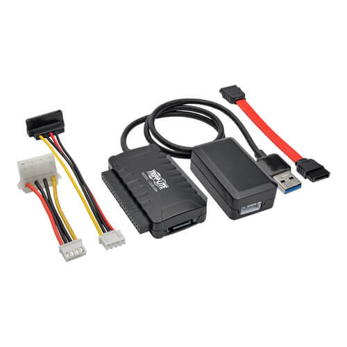

It is possible the enclosure has failed, even if the drive spins up. I would try the drive in a different enclosure or with a drive adapter cable such as this:
Is the drive "open-able"?
Many "store-bought" drives are not -- at least you can't open them without breaking the case.
Even if you do get it open, SOME Seagate and WD store-bought drives may not have standard drive connections inside, making it difficult or impossible to use the "core drive" with a dock, another enclosure, etc.
