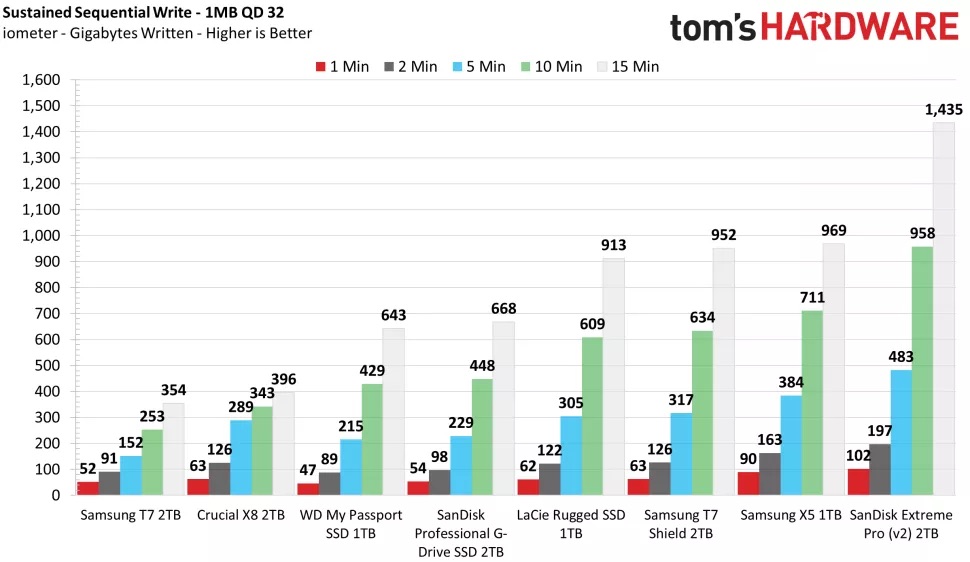

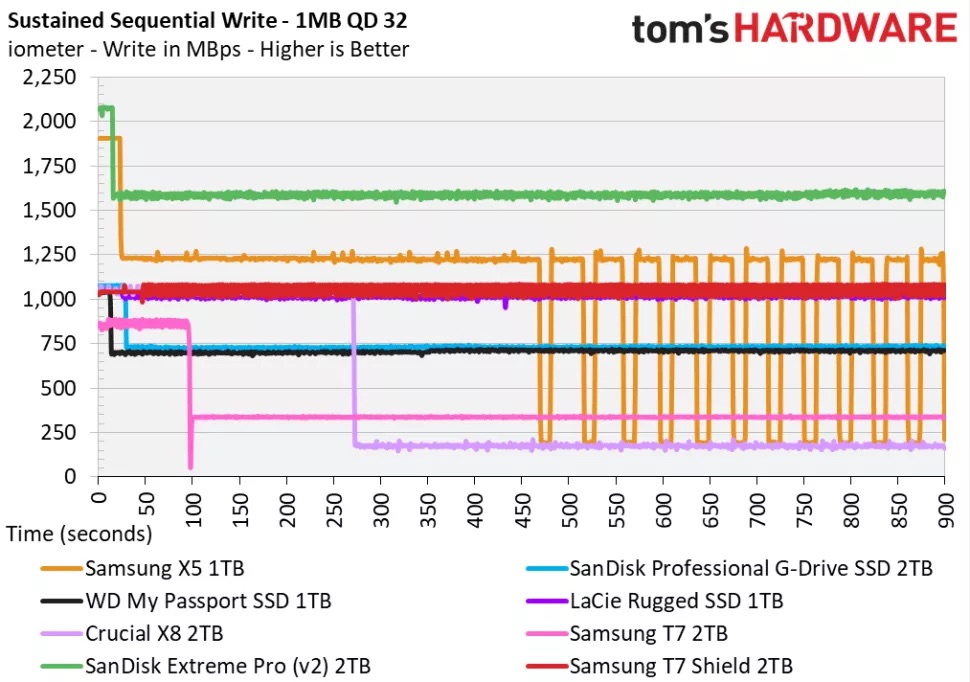

For a great USB-C option, there's the Samsung T7 Shield (but not the regular T7).
