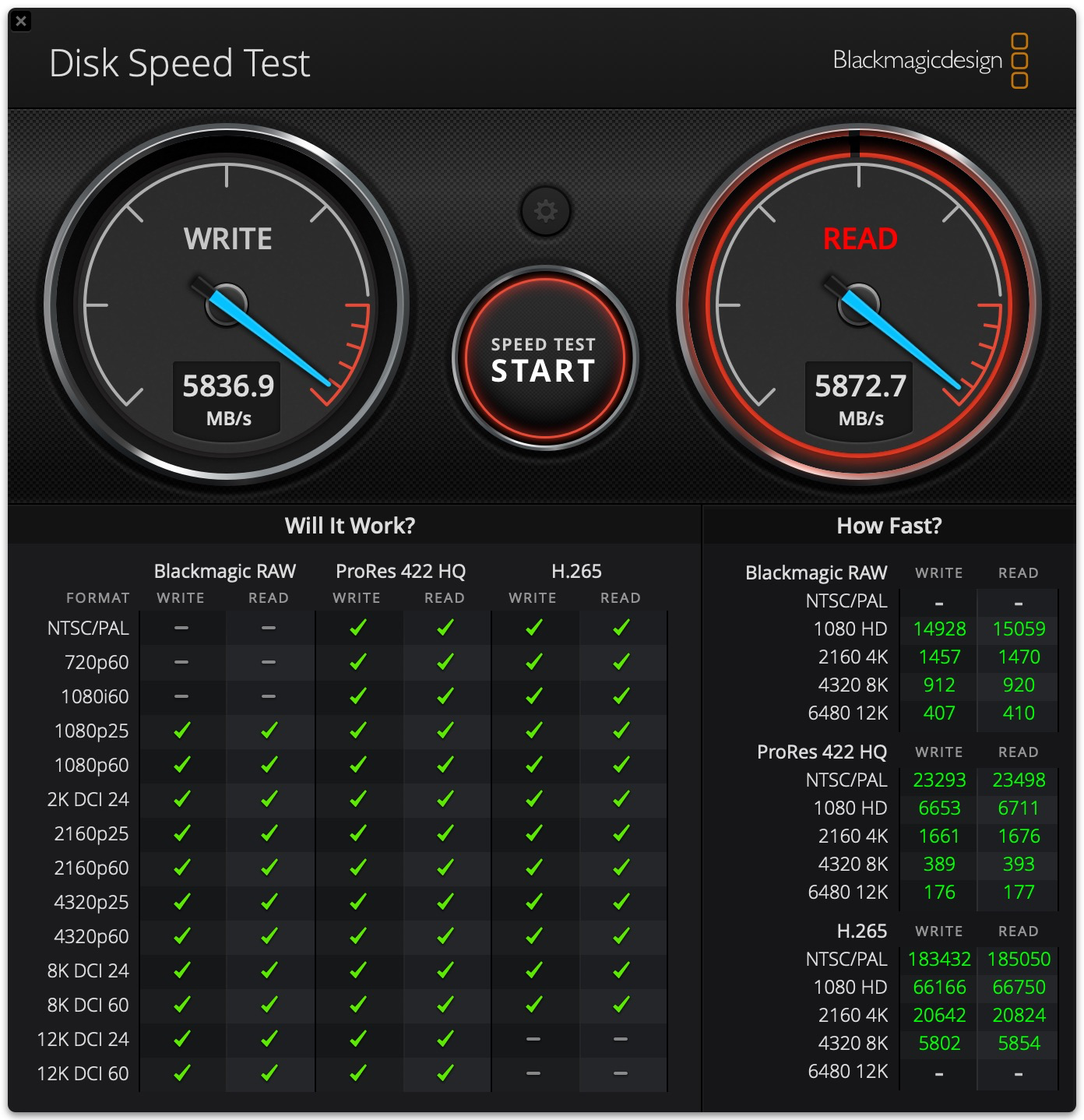

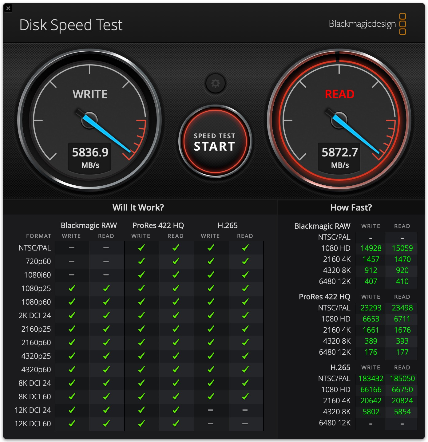

I bought the OWC first and I like it so much there's no need for me to try the Acasis. Passive cooling is more to my liking and the performance is outstanding. I tried the SN850X in it first, these were the numbers.

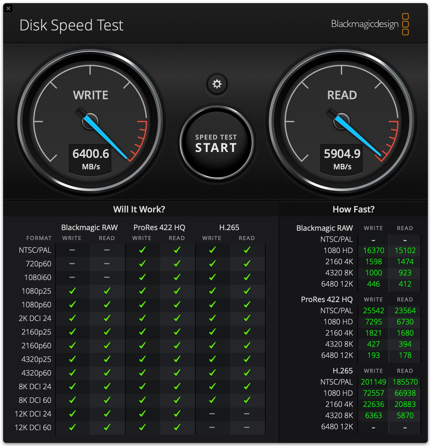

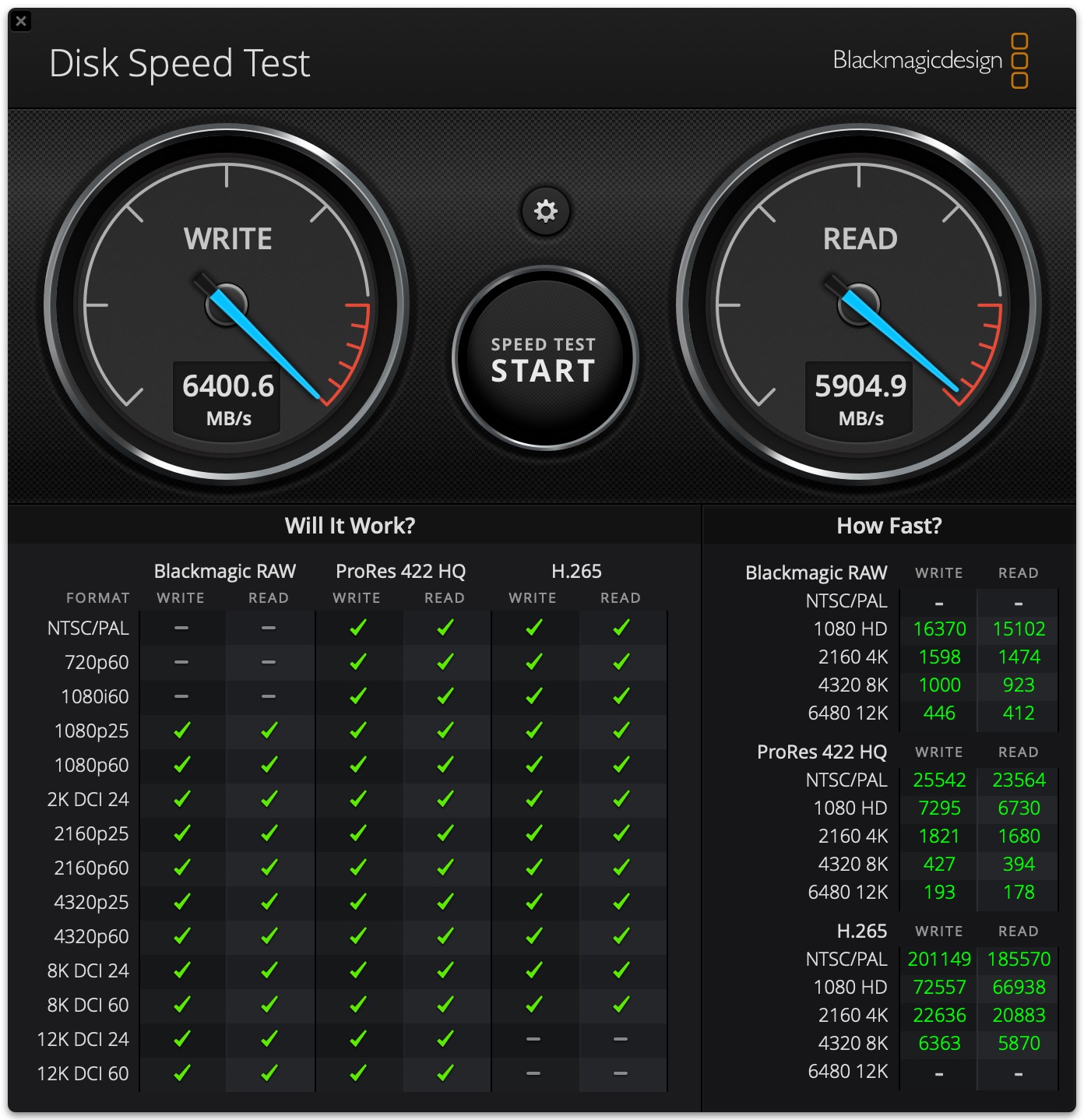

I put a 990 Pro in it a couple of hours ago and broke the 6,000 mark.

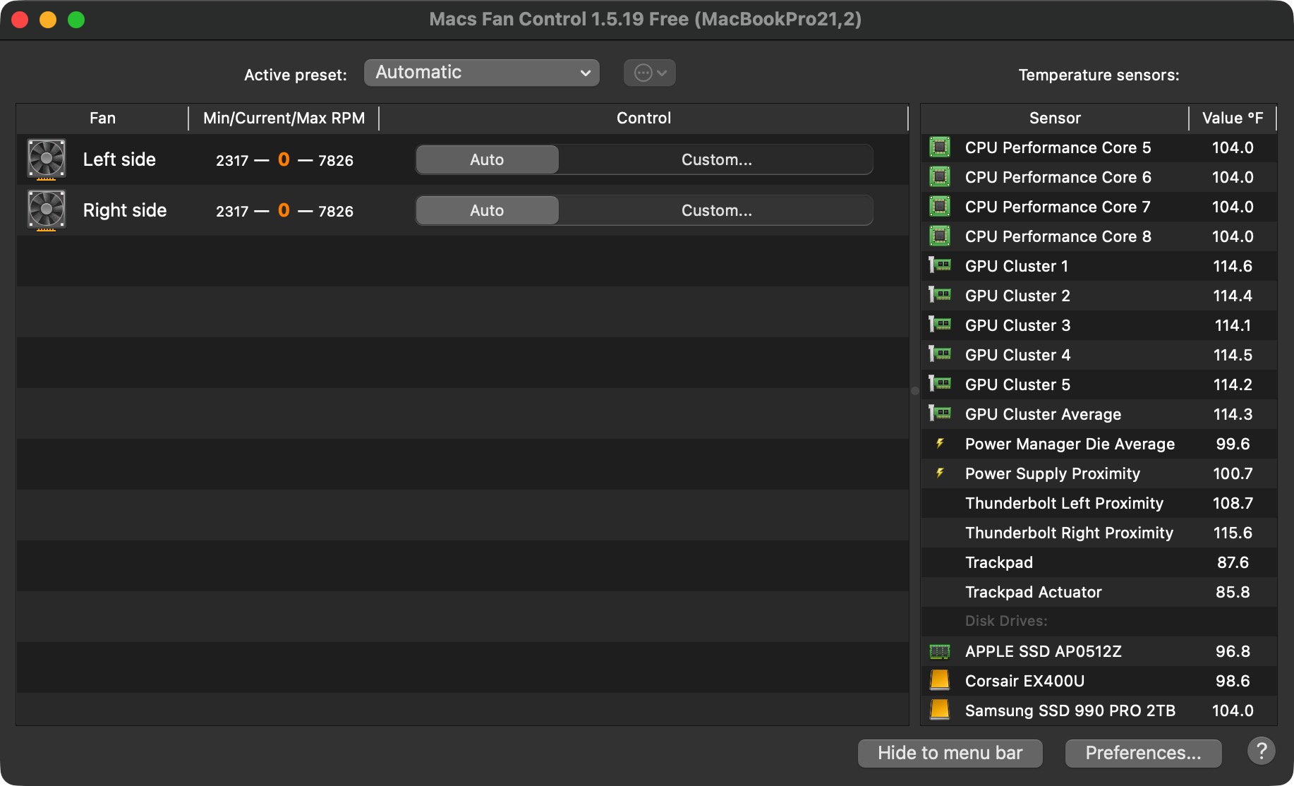

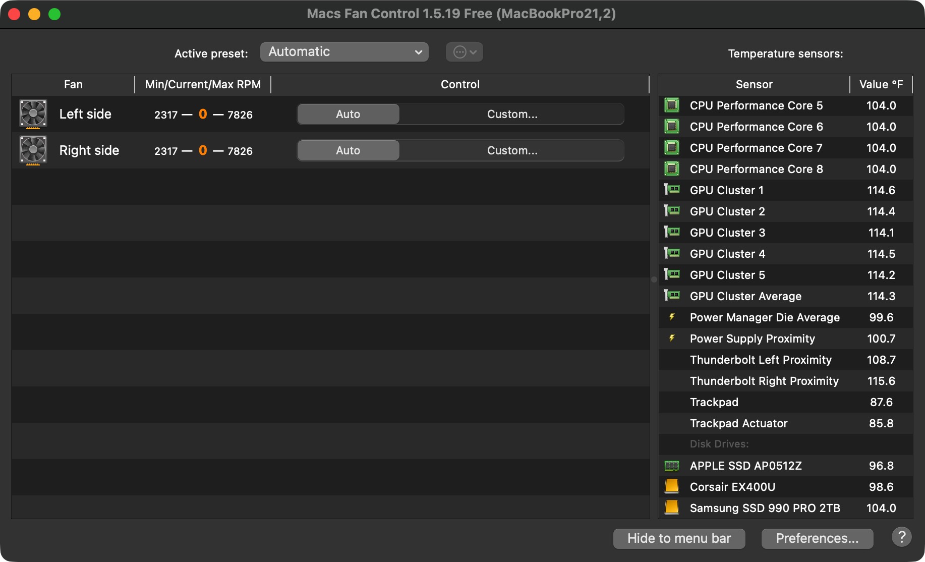

I'm going to keep the Samsung. They both max out around 118° F when writing hard, but what's more interesting to me is how warm the TB ports run. I hope mine aren't out of the norm for a MBP M4 Pro.

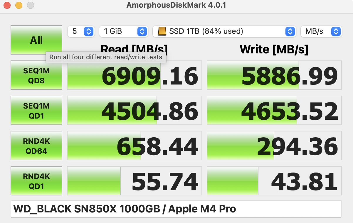

The WD SN850X makes solid 7.000Mb/sec Read and 5.900Mb/sec Write in the BeeLink Mate Mini Thunderbolt 5 80Gbit/sec Enclosure with one NVME (Model B) for example.
From: https://www.smartzone.de/beelink-mate-mini-test/ :

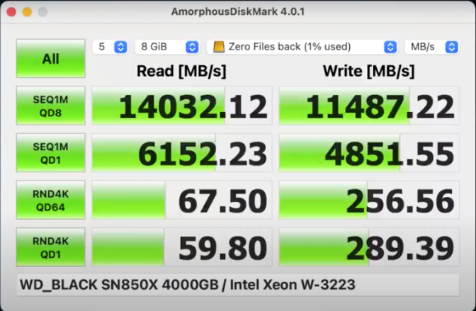

Almost half the speed of my internal setup in a 14 year old 2012 Mac Pro
Why These Numbers Are Physically Impossible
WD_BLACK SN850X Maximum Specs:
  • Read: ~7,300 MB/s
  • Write: ~6,600 MB/s
  • Interface: PCIe Gen4 x4
Mac Pro 2012 Hardware Limits:
  • PCIe 2.0 x16 slot: ~6,500 MB/s max (realistic)
  • PCIe 2.0 x4 slots: ~2,000 MB/s each
  • Total system bandwidth: ~10,500 MB/s maximum
  • DDR3 RAM: ~12,800 MB/s (dual channel) - still below the claimed 14,032 MB/s
The claimed numbers:
  • Read: 14,032 MB/s
  • Write: 11,487 MB/s
Conclusion​
These values are impossible. The Mac Pro 2012's PCIe 2.0 architecture cannot deliver 14 GB/s of bandwidth - not with a single SSD, not with RAID, not even from system RAM.
This is either:
  1. Benchmark error/bug (caching issue, miscalculation)
  2. Fake/manipulated screenshot
There's no hardware configuration in a Mac Pro 2012 that can physically achieve these numbers.
  • Read: ~7,300 MB/s
  • Read: 14,032 MB/s
Conclusion​
This is either:
RAID ;)
