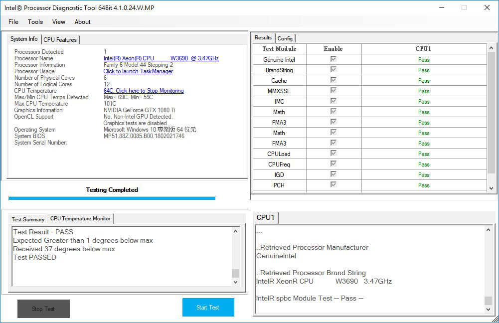

From memory, according to the Intel processor diagnostics tool, the Mac diode temperature for X56xx should be 105C, not 125C.
And thermal throttling will occurs before that.
The native SMC fan profile should able to keep the CPU just below thermal throttling point. However, if the thermal paste dried up, or the heatsink is a bit dusty etc. Some momentary temperature fluctuations may lowering (or even disable) turbo boost.
And the max turbo boost won’t comeback back again until the cpu cool down again quite a bit.

I’m 99% sure that 105°C is for the lower grade Xeons (E and W). The X reach up to 125°C.
W36xx is 101C, 100% sure. I checked that by myself.
